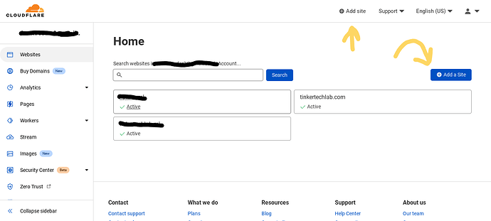

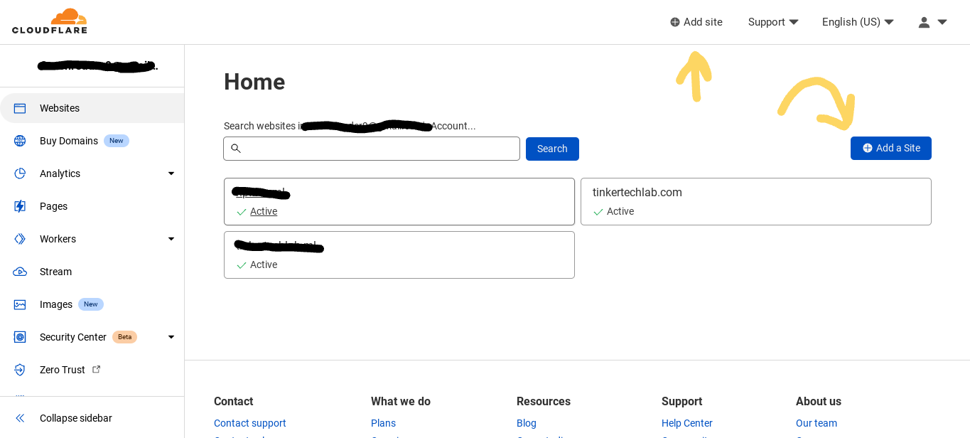

  1. Go to Dash.Cloudflare.com and create a new account, or log in to your existing one.
  2. Add a Site (by clicking on the Blue Button or the “Add site” option at the top).

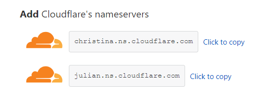

  1. Go to the Domain Registrar of your domain (You can look it up by searching your domain here) and change the Nameservers to the ones provided by Cloudflare.
    (You may have to scroll down on the page to see this box with the nameservers. Note that you may have different nameservers from those shown here.)
    Important Note: The Nameservers provided by Cloudflare should be the ONLY 2 nameservers on your domain. Remove all other nameservers!
  2. After changing the Nameservers with your domain register, click the “Check” button at the bottom of the page. Note that it may take up to 72 hours for Cloudflare to detect the change.

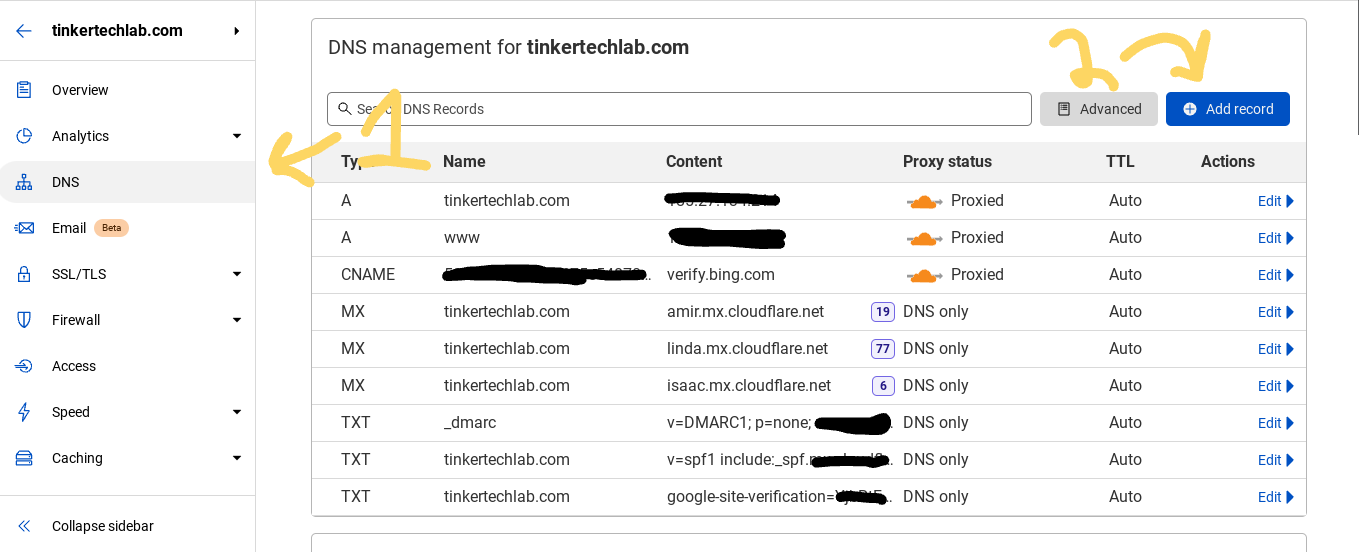

  4. In the DNS section, click on the blue “ADD RECORD” button, then choose the “A” record type. (NOTE: Steps 6-8 may be done for you by Cloudflare!)

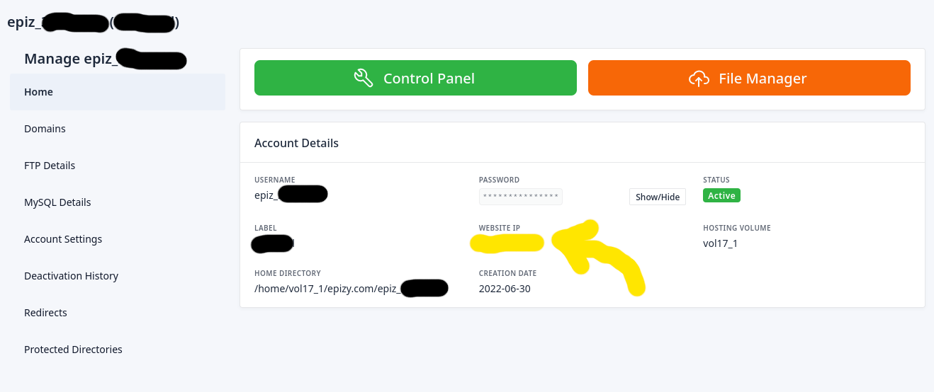

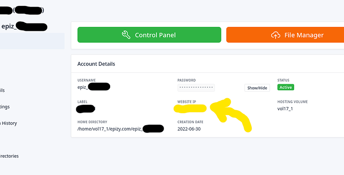

  1. In a new tab, go to dash.infinityfree.com, log in if needed, then select the hosting account you want to add Cloudflare for. Locate the IP address. (NOTE: Steps 6-8 may be done for you by Cloudflare!)
  1. Copy the IP address from the client area (dash.infinityfree.com) and use it to create the following records: (NOTE: Steps 6-8 may be done for you by Cloudflare!)

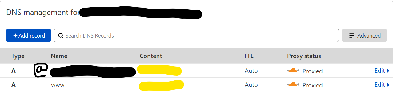

RECORD #1
TYPE: “A”
CONTENT: “@”
NAME: IP address from dash.infinityfree.com
RECORD #2
TYPE: “A”
CONTENT: “www”
Note: Keep the cloud orange for both of the records!
  1. Double-check that it looks right! (The yellowed-out text should match all other yellowed-out text.)
  2. If something looks wrong, go back a few steps and see what you missed. If it all looks good, your site should start working within 72 hours. If it has been over 72 hours and it still does not work, try clearing your cache. If clearing the cache does not work, create a new topic in the Hosting Support category.
