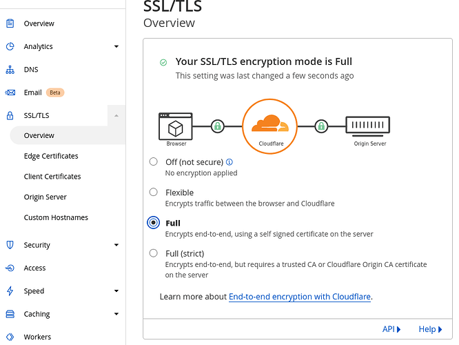

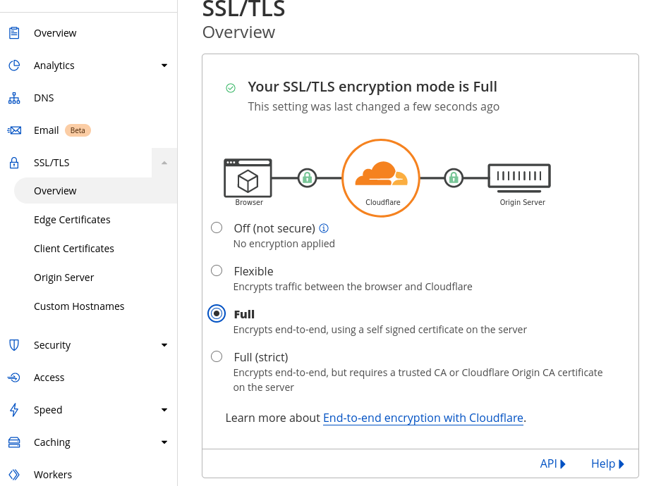

To do so, login to the Cloudflare Dashboard, go to your domain name, then go to “SSL/TLS” → “Overview” and set the encryption mode to Full.
And for the most part, this is all you need to start using Full SSL!

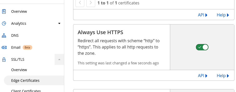

Enable Always Use HTTPS in Cloudflare
Once you’ve configured your website to work with HTTPS, you should force everyone to start using it.
The best way to do this is to enable the setting “Always Use HTTPS” in Cloudflare. You can find it under “SSL/TLS” → “Edge Certificates”. Enabling this setting will make everyone always use HTTPS on your site.

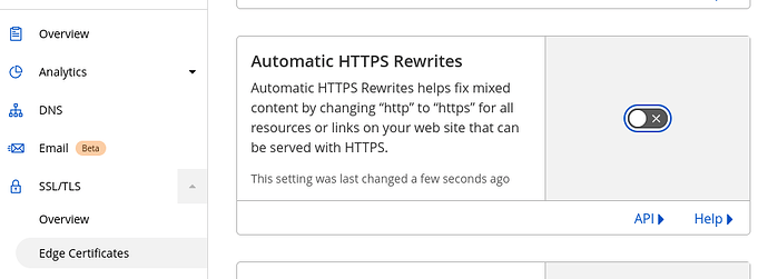

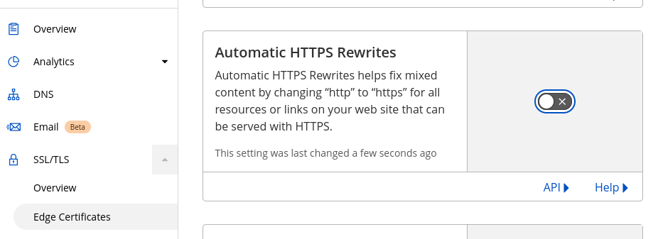

While you’re on that page, you should also make sure that “Automatic HTTPS Rewrites” is turned OFF. This setting is generally not necessary, can hide other configuration issues and cause weird errors.
