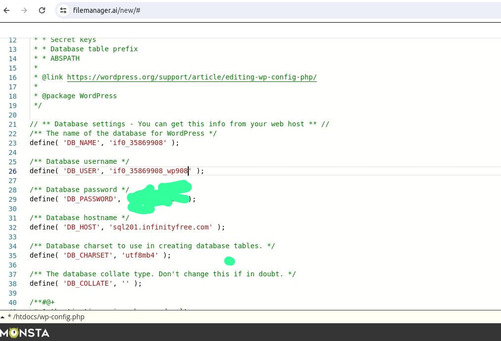

I took a closer look to the file in the screenshot and I think I’ve found the problem: now the database name and user are changed in place and are respectively the database user and name instead. As database name you should put what you put on the database user and vice versa.
This is my last update, version:

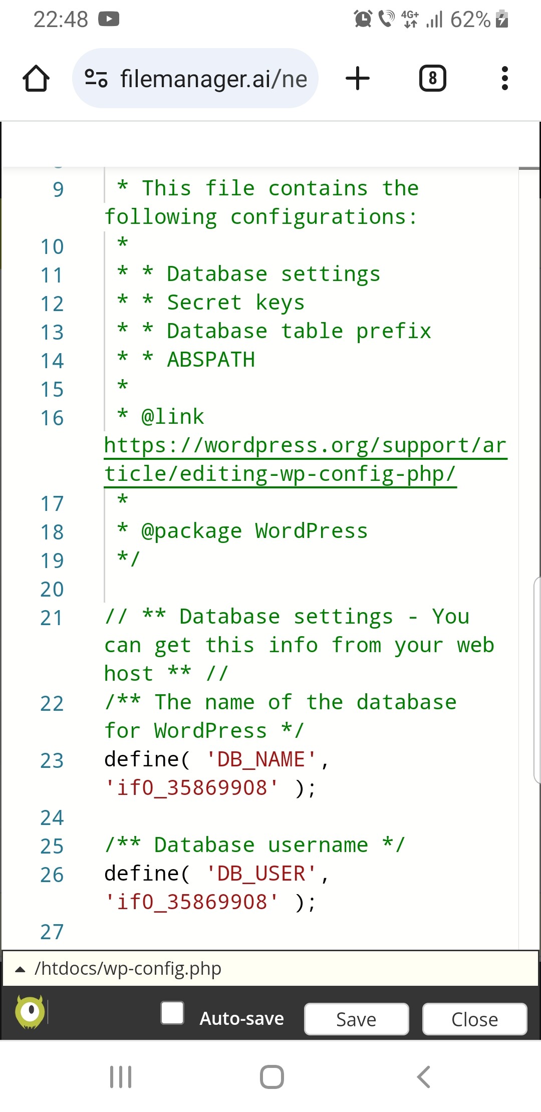

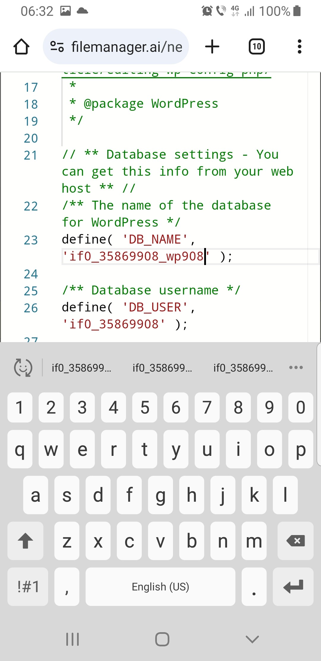

Now the database user and database name are equal, while they shouldn’t be; the value for the database name is the database user name, followed by the database actual name separated by an underscore (so if0_35869908_wp908).
/** The name of the database for WordPress */
define( 'DB_NAME', 'if0_35869908_wp908' );
/** Database username */
define( 'DB_USER', 'if0_35869908' );
I don’t know why it is so hard for you to understand what should you write inside that config, but here’s the final version for you.

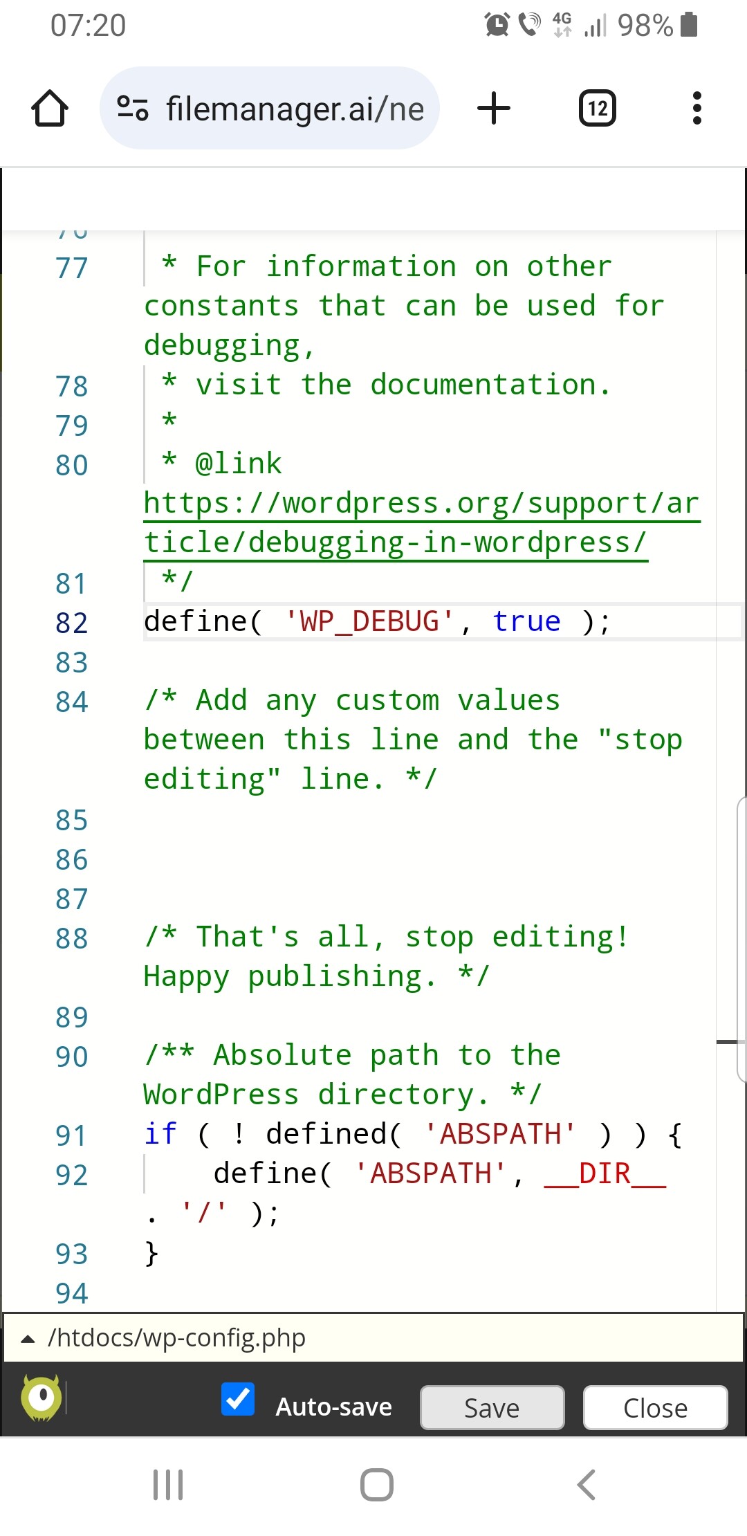

Could you please enable debug mode by changing
define( 'WP_DEBUG', false );
to
define( 'WP_DEBUG', true );
so you can see the actual error cause?
Done. Thank you @Meishin

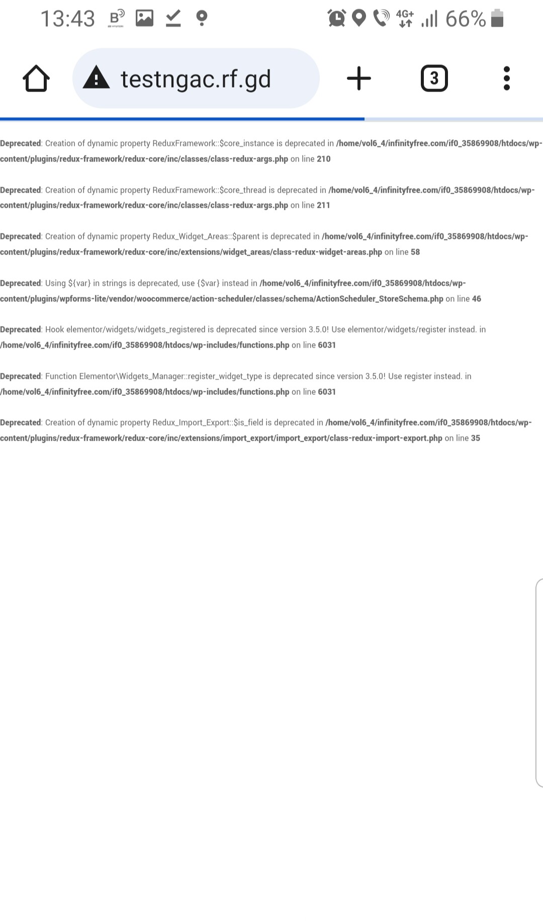

You are awesome @Meishin ! Some parts of the website are working. Do you have any ideas about these errors please?
This means the plugin redux-framework is so old that it cannot keep up with the latest PHP version. I advice you to seek for a new version of the plugin that supports PHP 8.2, or just stop using that plugin and use an alternative option.
You have to google that unfortunately, as I have no idea about what that plugin does.
You may ignore that right now as Deprecated functions may still work for a while. Change the WP_DEBUG option back to false will hide these errors. But it’s still recommended to seek for a new version instead.
Not necessarily. It’s possible the plugin authors are already aware of this and are working to fix this in a future release, so they are ready when PHP decides that this obsolete code will stop working.
So I would suggest to just disable WP_DEBUG and ignore these messages.
