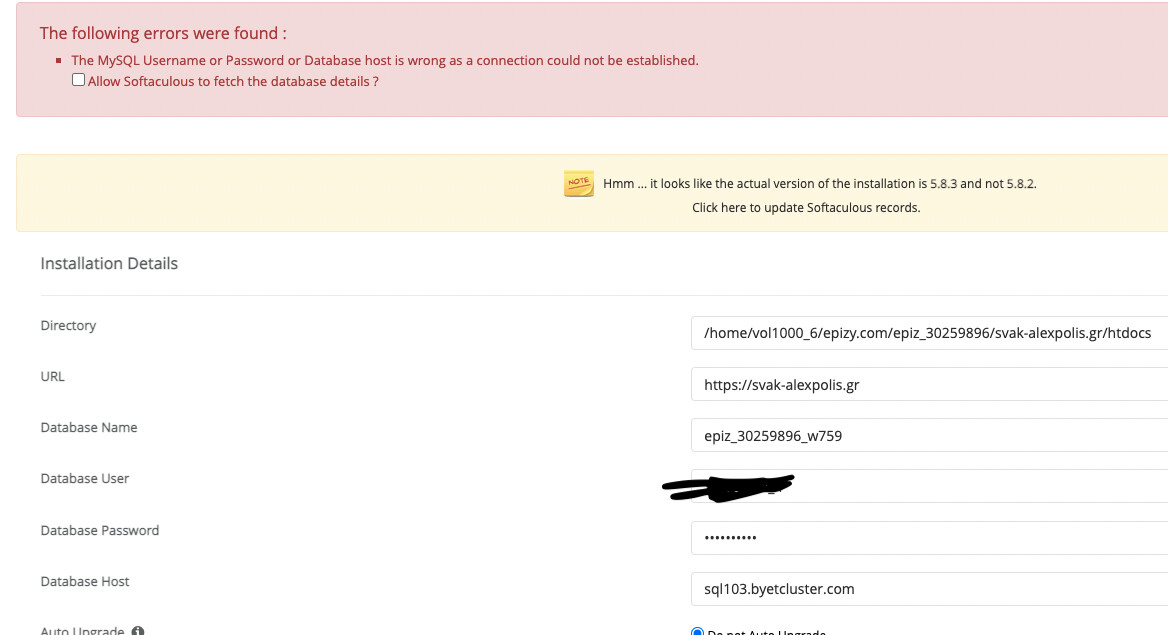

Hi, i had the same problem and the databases were disappeared. Now after i opened a ticket to
ifastnet the database seems to be back, but i still get the same error when trying to access my site “Error establishing a database connection”. I have a softaculous installation.
Please could you advise?
Username epiz_30259896
Main Domain jkzkda30.epizy.com
http://svak-alexpolis.gr
Maybe your sql server changed. Verify the credentials in wp-config.php to the ones in the Client Area.
I have the same values in softaculous:
and in the wp-config
The value in the client area is different, but this is also the same for other sites that work.
Any suggestions?
I would recommend to use the database username and password shown in the client area, and the database hostname shown in the control panel. Those credentials are best guaranteed to work.
thanks a lot. it worked.
