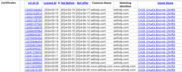

Strange, you have many SSL certs created for the same domain
That goes back to before I started using InfinityFree (around March 16/17). Before IF, I was using the domain name for a tumblr page. Tumblr takes care of the SSL stuff automatically- maybe they renew SSL certificates every day or two…?
