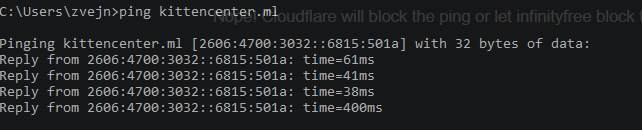

Now, wait a bit and try to ping your website through CMD:
ping (yourdomain)
If it doesn’t work, something has gone bad, try setting the records at Cloudflare again.

  • Pinging the server after adding to Cloudflare will just ping the Cloudflare side, not your origin server. (To prevent DDoS attacks)

Nope! Cloudflare will block the ping or let infinityfree block the ping.
Works for me idk
Cloudflare doesn’t block pings, but IF does

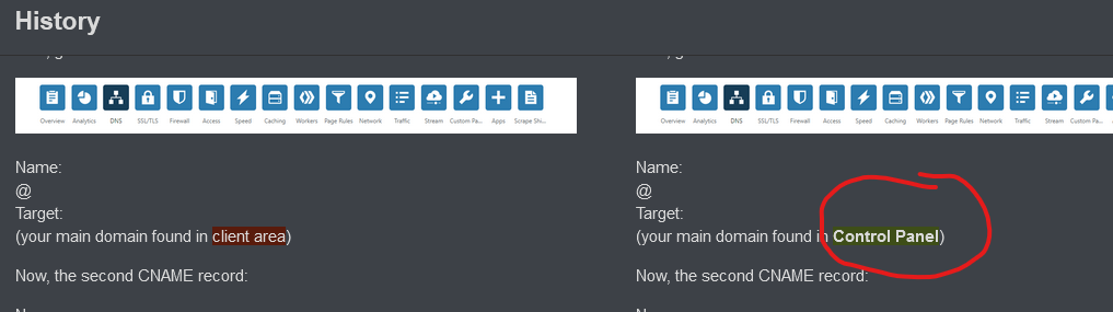

“Now, create a Cloudflare account and add your site to it.”
This is where I am stuck. I’m at the “2) Review your DNS records” stage - but if I put in the CNAME records as described, I get a red error bar with DNS error 1004.
Any chance of padding out the “add your site to it” bit?
This article explains the general process more in-depth:
“main domain” (CNAME) is mentioned in this topic
and I think you misinterpreted it
The “main domain” we’re talking about here is the main domain of the hosting account. That’s an internal identifier for your hosting account and it should look like asdfasdf.epizy.com or another random 8 character subdomain.
The tutorial is old - so some locations are no longer current.
I edited it so it wouldn’t confuse someone else
