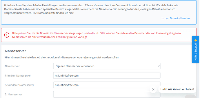

Hello, when I want to register my site to a custom domain, I get this problem from the DNS provider. I am posting the English translation below, thank you in advance.
“Please check whether the domain is registered in the name server and active. Please contact the operator of the name server you have registered, as there is probably a misconfiguration here.”

Is there any way to do this by changing the nameserver?

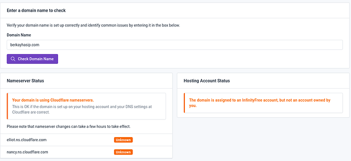

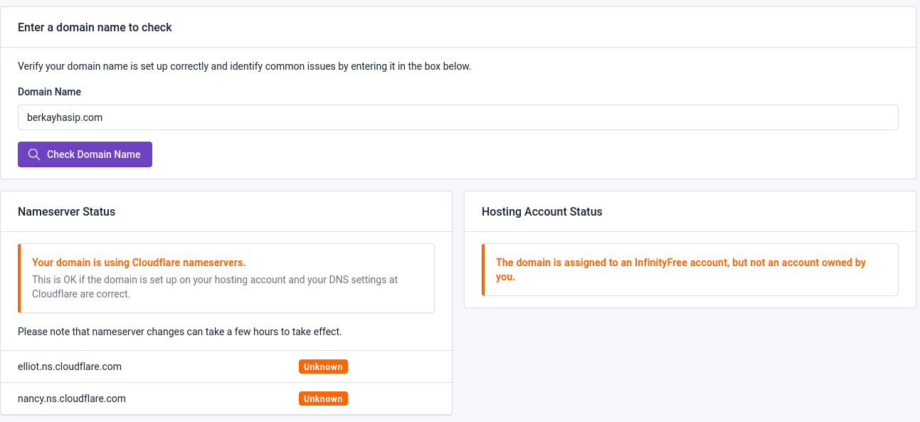

Wait, is your domain connected to an account or not?
If it is connected, you don’t need to do anything with NS/CNAME, as those things are only to connect the domain to your account.
Once your domain is connected, create two A records with “@“ and “www” both pointing to the IP address shown in the client area with your DNS provider.

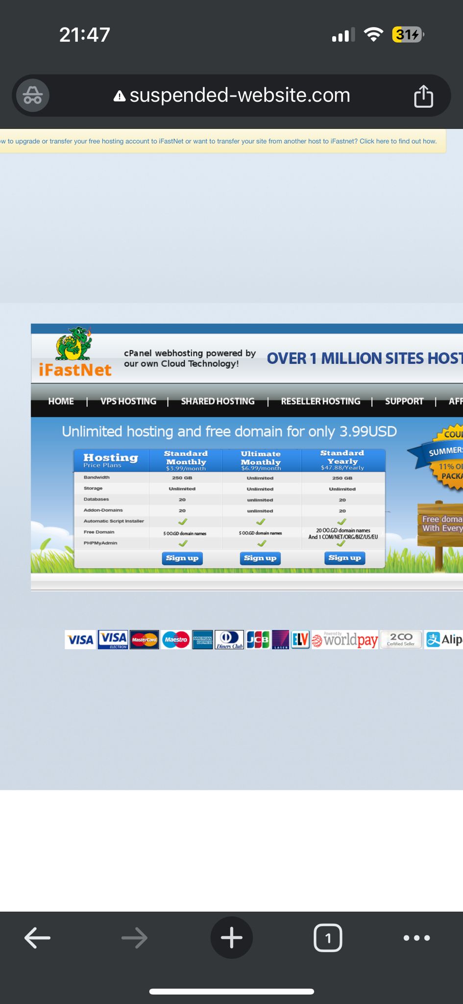

It automatically takes you to a site like this on mobile

Now I see that whenever I enter the new domain into the browser, it redirects me to the old domain and shows me ads because it is not active. Is this due to a problem in htdocs or am I thinking wrong? or how
Remove the top 4 AAAA records (And remove the rest of them if you don’t need them).
