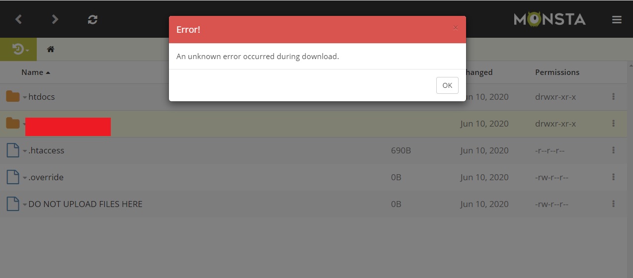

When i am download my website in file manager. i found “MFTP error” I can’t download my website.

no. i am not found any error during using website. but i found some errors when i download my website only. i want backup my website. but i can not backup my website.
i tried before a few minutes. error is change. and now i can see a error. i upload a screenshot. please check and solve my problem. i tried in filezilla. but i can’t download it. i found some error also in filezilla.
The bottom error is the ftp server agressively shutting the connection down due to the fact that it timedout (as you can see after 120 seconds the server shuts your connection).

Seeing how you get a download error while looking at the root folder: don’t bother trying to archive and download a full website through a web based file manager. It will choke and die if you try to compress or extract too many files. A desktop FTP client is the way to go.

In File manager I found Same Error. Error2

But if i want backup my full website. Than how can i full backup my website ? I want full backup my website now. And these features is not working correctly. Please solve it now. It’s too urgent.
These problem is from server side. Bcoz i tried in another device to. Now i found these error → “An unknown error during download” please solve that problem.

What did you try exactly? Did you try it with the web based file manager? Because I can tell you from the start that backing up a full website through a web based file manager just isn’t going to work, no matter what you try or from where you try it. You could call it a “server issue”, but it’s not something that can realistically be solved.
