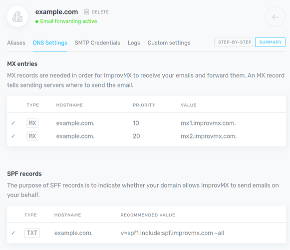

The first thing to figure out is to check with MX records you need to use. For ImprovMX, you can find these details by clicking the gear icon next to your domain, and go to DNS Settings.
These settings look like this:
As you can see, for ImprovMX we need to set up two MX records.

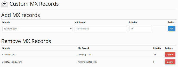

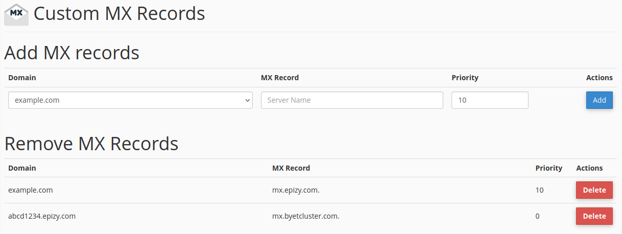

Next, we’ll login to the InfinityFree control panel, and go to the MX Records section.
Before we can add the new MX records, we should first delete the MX records that are currently there for the same domain.
As you can see, there is one MX record present for our domain “example.com”. This MX record should be removed.
There is also one record for the domain “abcd1234.epizy.com”. This is our account’s main domain. This record cannot be deleted, but it doesn’t matter.

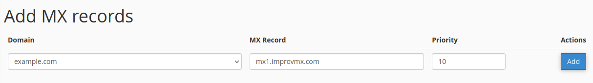

Now it’s time to add the new records for ImprovMX.
For each MX record that the email providers tells you to add, add a new MX record like this. Select the right domain name from the list, enter the MX record value from the provider and enter the correct priority.
Note that the MX Record field in the control panel must not end with a period. So if the email provider writes their MX record value with a period at the end (like ImprovMX does), simply remove it from the value.
Then simply repeat these steps for each MX record.

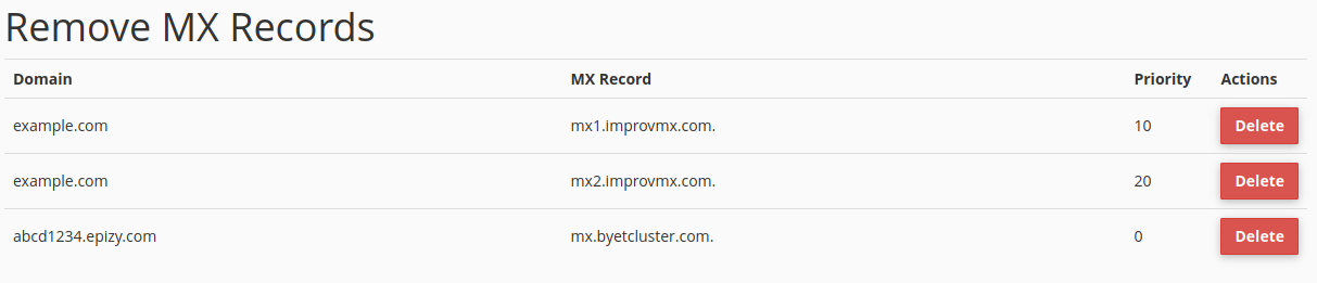

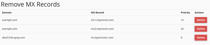

When you’re done, the MX records table in the control panel should look something like this:
