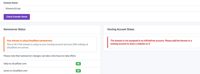

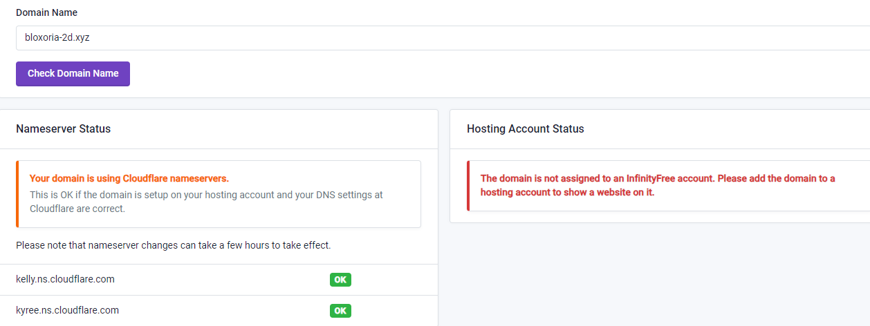

Just removed the first one, heres what i get when trying to connect
I see this
You need to do this first
before adding domain to hosting account
I want to use cloudflare within
You have to first add the domain to the hosting account (by pointing it to InfinityFree’s nameservers), then you can change them to Cloudflare’s ones and setup Cloudflare for your domain:
