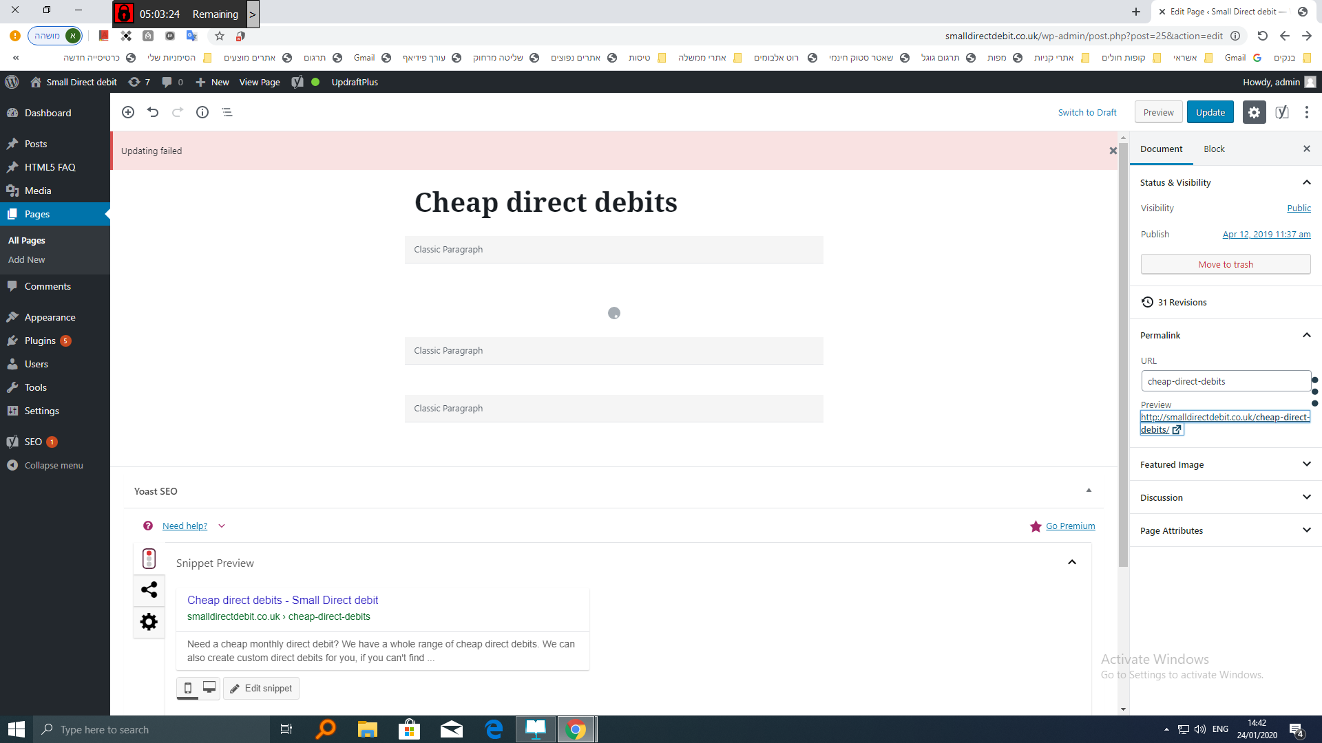

Maybe I spoke too soon… I can log in to WordPress, but when I try to edit a page it doesn’t diplay the page at all. I get this
Could this be because I changed the URL to HTTP, and the page is still HTTPS? How can I change this?
