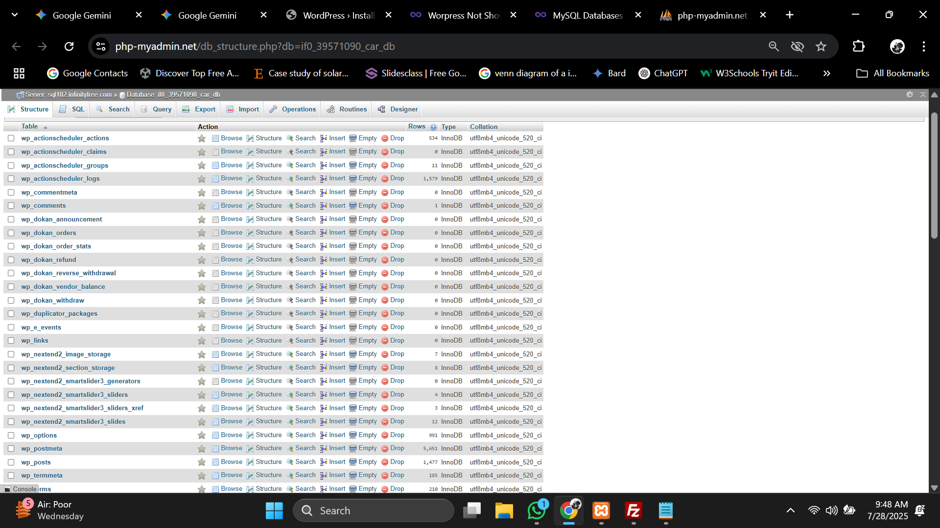

Please show the if0_39571090_car_db database.

If you see the installation wizard when trying to access your website, that usually means that either the configuration file was not found, or the database data it points to was not found.
An incorrect table prefix can definitely cause this, as it will make WordPress believe that the tables are missing.
That said, I’m surprised you would have this issue. If you migrate the database and wp-config.php files of the same sites, the table prefix in the configuration and the database itself should match.
From what I can tell, it’s another example of attempting to use Softaculous to migrate a website. Just look at the table prefix.
what should i do now?
Did you even read this?
You need to change $table_prefix inside wp-config.php to wp_

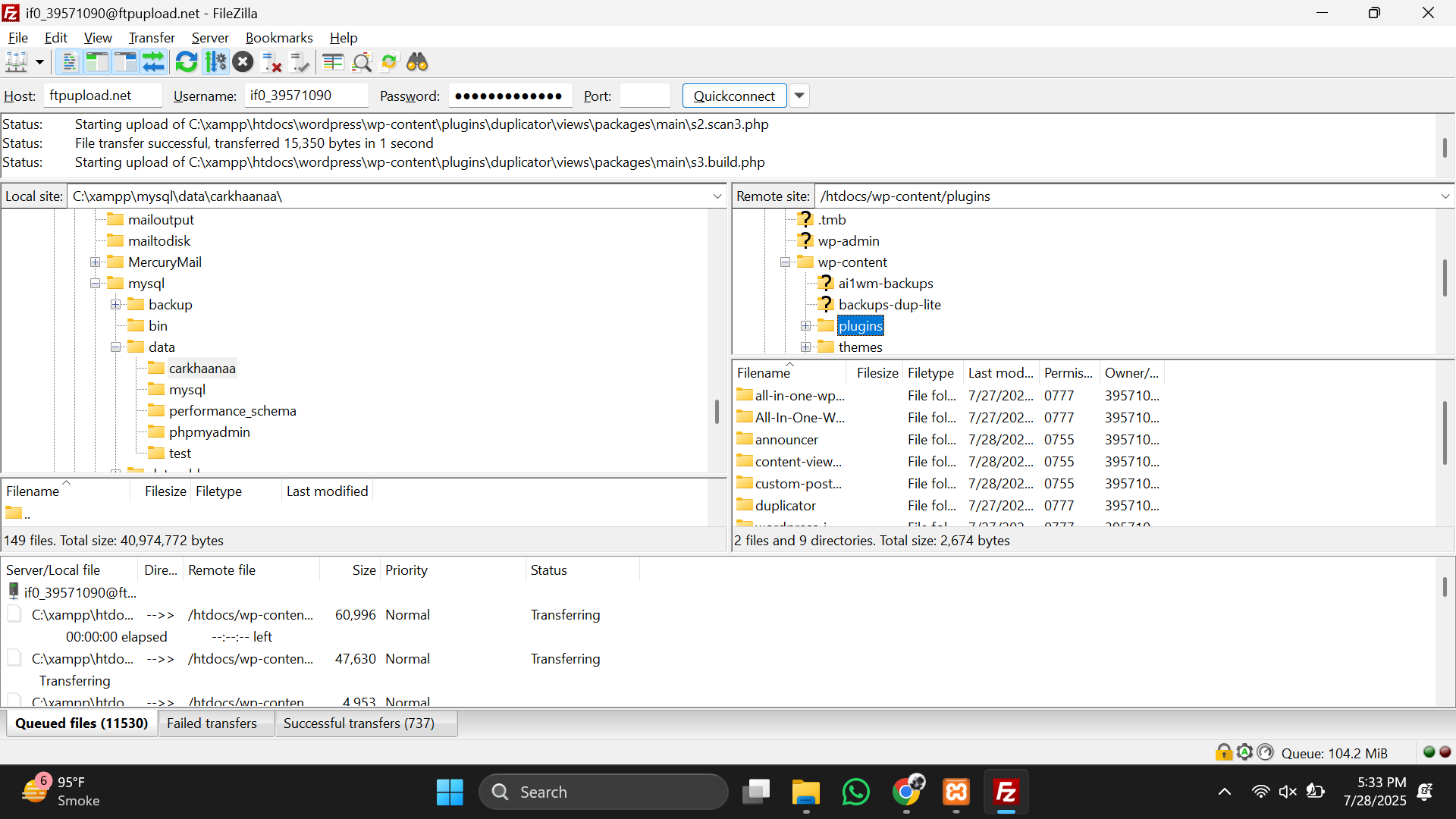

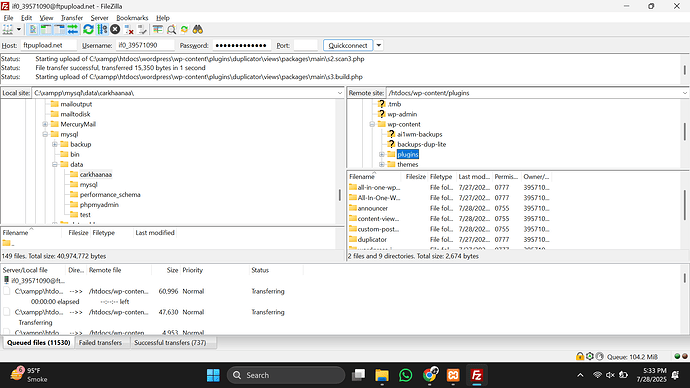

done but i have to manually change folders like
it should be automated but when i opepend and login and visited my site there was nothing but then i goto local side ht docs and copied their plugins and all stuff to ht docs of remote site acutal site what happened by page loaded
but still one bottleneck
on local host my web was in mysql carkhaanaa but in remote site there is no configuration for my web
see this
