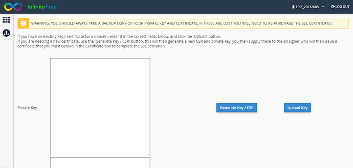

Hm. Maybe the certificate was not installed correctly? Can you screenshot the SSL page in the control panel?
Thanks
yes sure, in the second picture everything is empty.
Oh. Your getting the error because you have no SSL on InfinityFree. On the client area page (infinityfree.net/ssls) you need to complete the CNAME checks (so they say “ready”) and copy and paste the certificate and private key provided into the control panel. Once you do that, your site should work fine.

Copy the private key to the private key section and click upload key. Then copy the ssl certificate to the certificate section and click upload. I see that you are using let’s encrypt which is fine however it needs to be renewed very 90 days. A self signed SSL is valid for 15 years. The only thing different is that you need to set the SSL status to full and not full strict.
