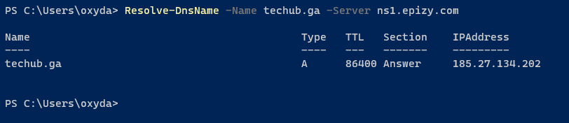

You are currently using Cloudflare
and that’s why your website has CF IP 172.67.204.4

but one is the IP of your website that is currently on Cloudflare and uses CF IP
and the second here is the internal IP address of the hosting where your domain is located

The IP address you use to access your website is not (necessarily) the IP address the server is using to access other systems.
If you want to know the real value, you can create a PHP file (e.g. test.php) with the following content:
<?php
echo file_get_contents('http://ifconfig.me');
And then open example.com/test.php in your browser to see the IP address.
