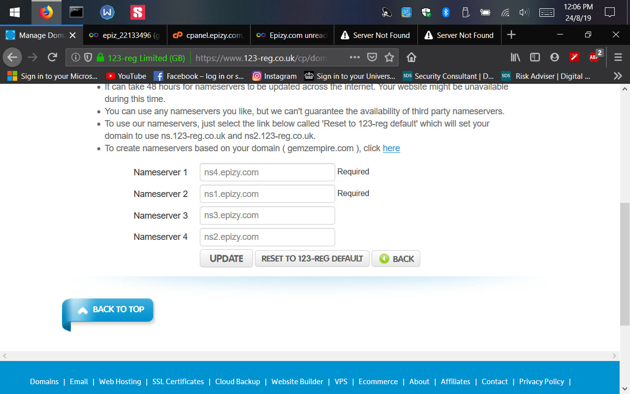

ive just checked nameservers and they actually appear to have been rearranged?? NS 1 is now NS 4 etc - this may have been result of your outage very strange - see screenshot
Don’t worry about the nameservers being arranged; just change them to the ones I specified.
