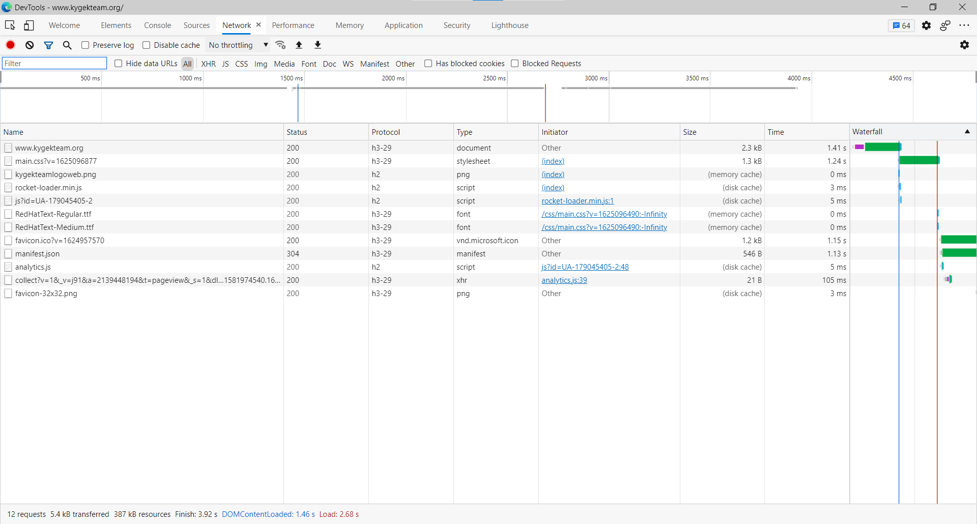

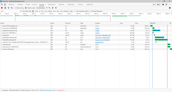

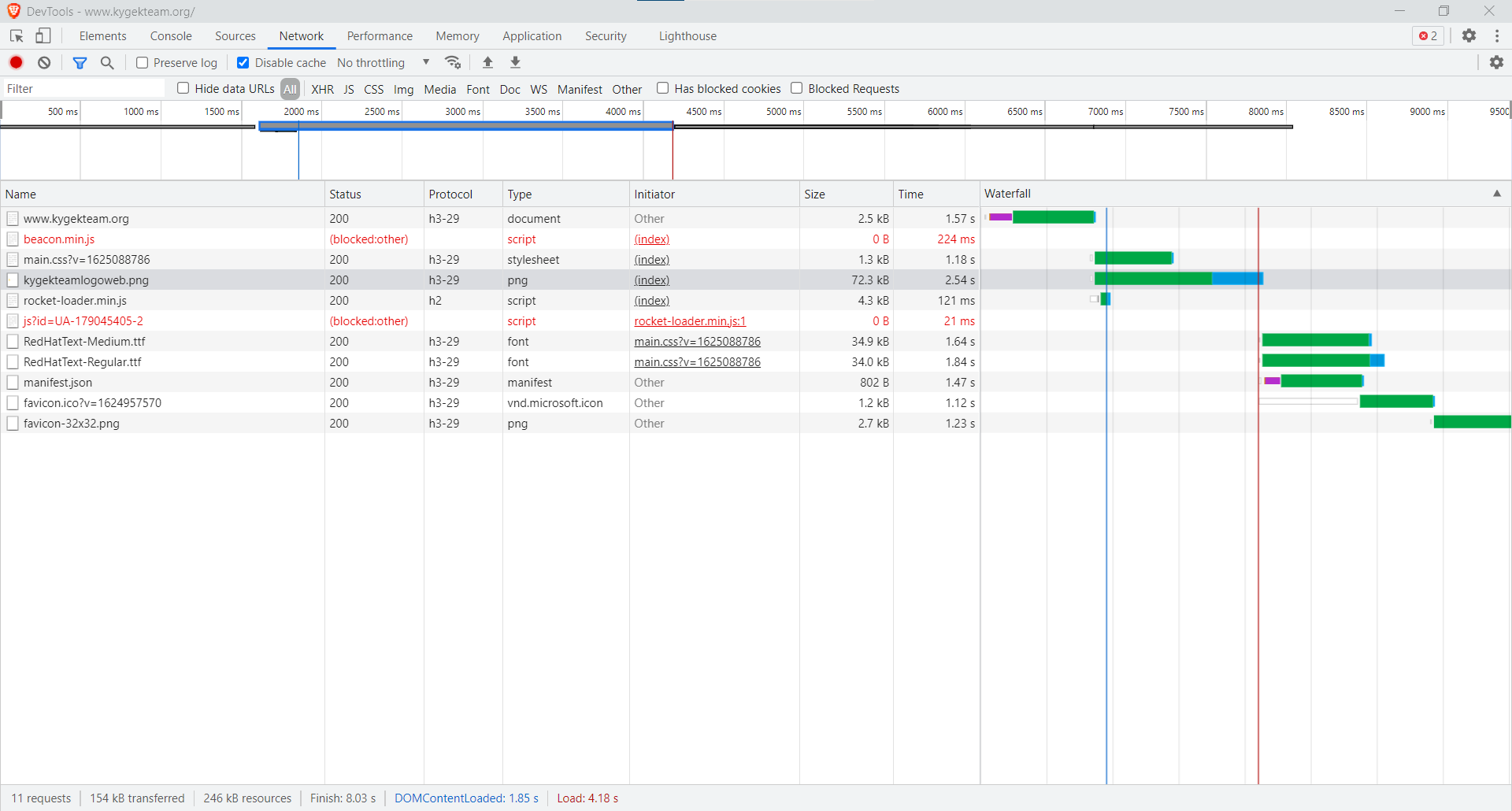

https://www.kygekteam.org:

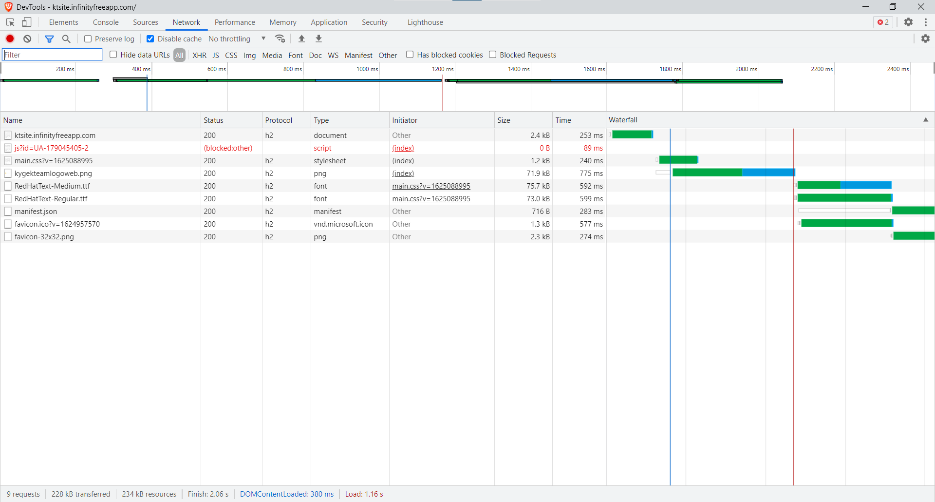

https://ktsite.infinityfreeapp.com:
The only difference I see is in the protocol (one is h2 and the other h3-29). Supposedly h2 is faster, but that dosen’t seam to be the case here.

If you see the first image of kygekteam: , you will see that cloudflare’s rocket loader is enabled, but not loaded, blocked.
According to cf
Rocket Loader prioritizes your website’s content (text, images, fonts etc) by deferring the loading of all of your JavaScript until after rendering. On pages with JavaScript, this results in a much faster loading experience for your users and improves the following performance metrics:
I am not sure, maybe this the other reason with http/3

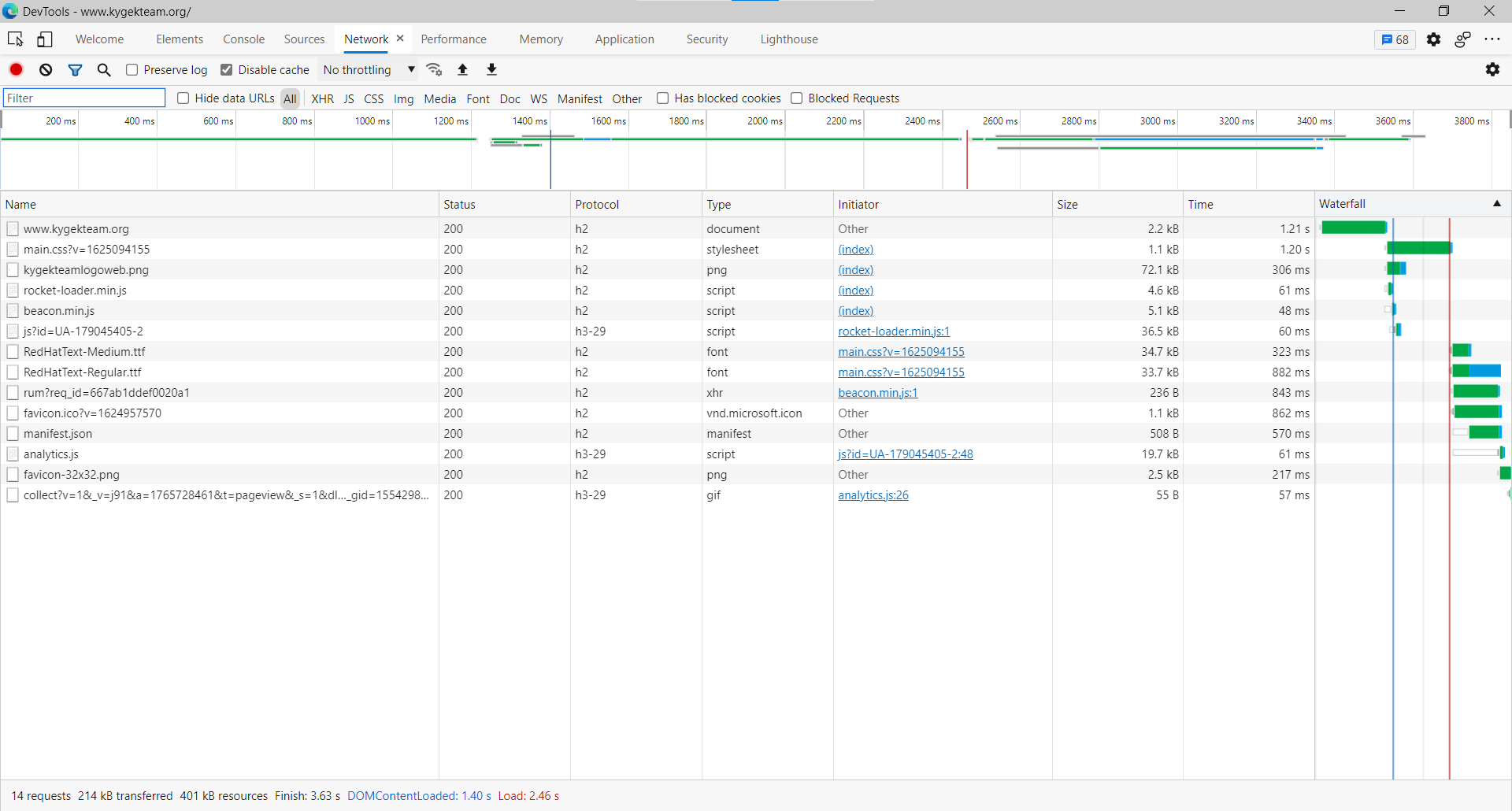

Custom Domain still loads slower even though I’ve disabled HTTP/3 in Cloudflare and used a fresh Windows Sandbox.

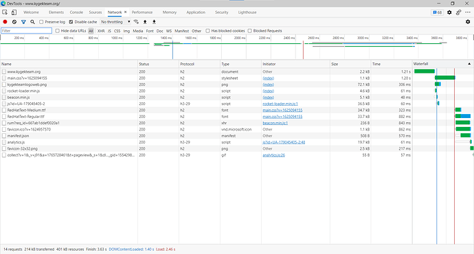

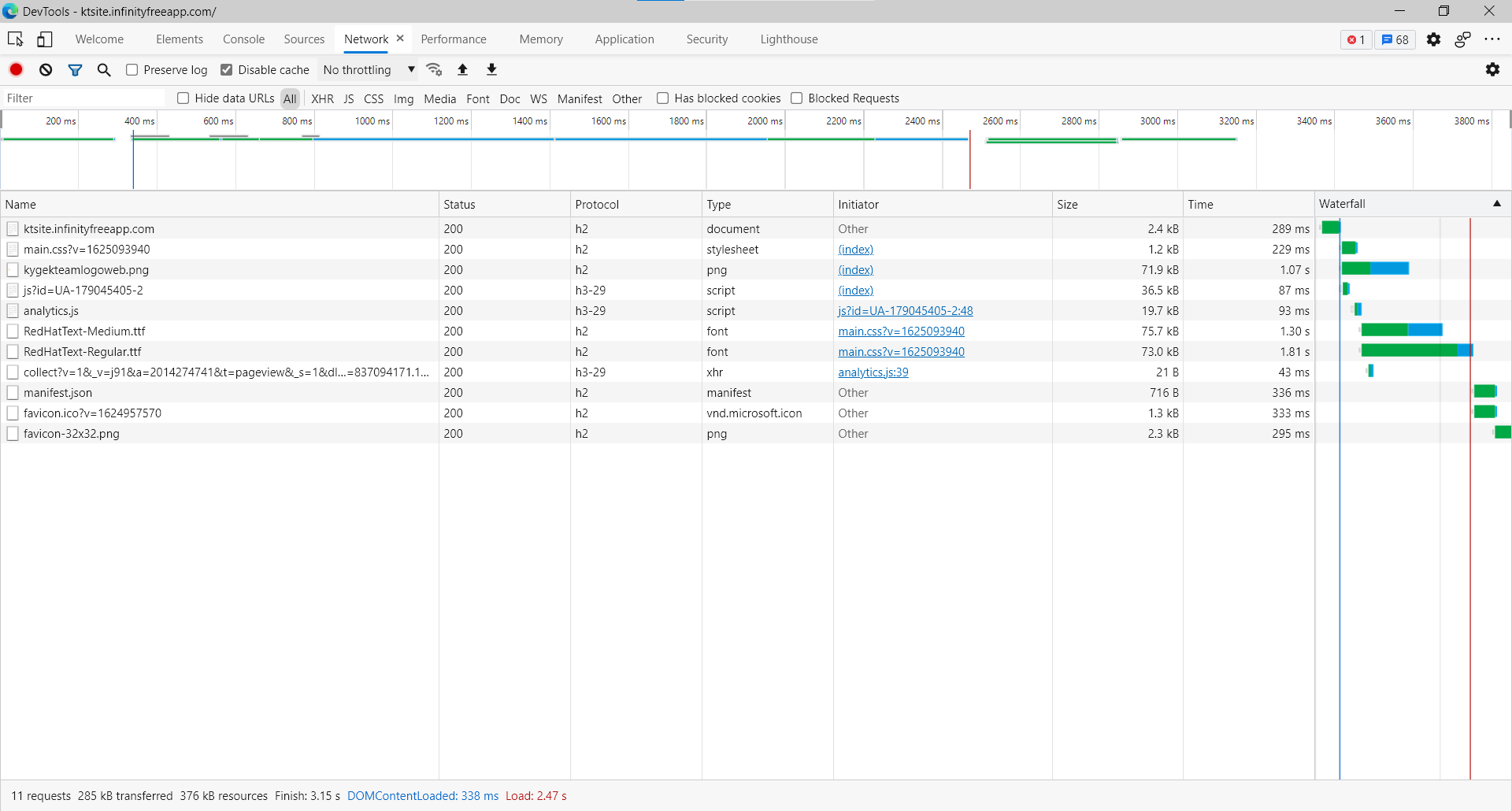

Just test it in your browser and see the loading duration difference.
Well, you do make 4 more requests, and although there is less data, the process of requesting the file takes time. It still does seem a tad bit high, but don’t expect it to less or the same unless your remove or combine resources.
3 to be exact, and 3 of them are JS files for Cloudflare Beacon and Rocket Loader.
What? I though it said 16 not 15… Either I read it wrong or you changed something to mess with me :joy: I guess that what happens when you are debugging in IE (Stupid browser)
Ah, it is 4, I was right.

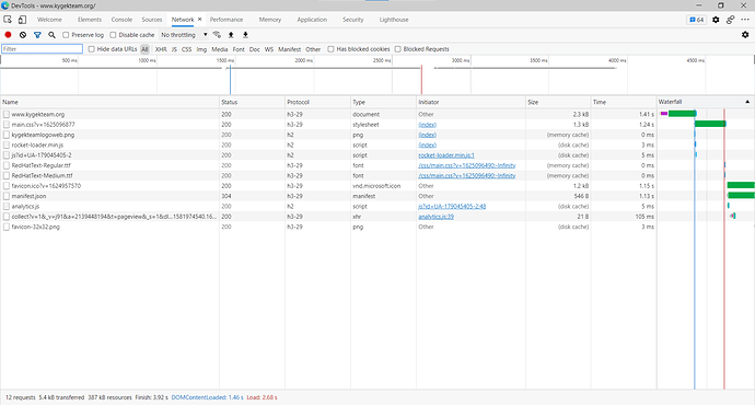

Custom Domain:
Subdomain:

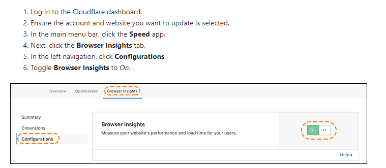

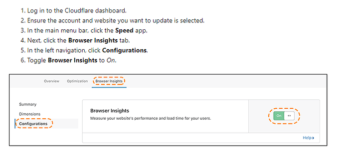

Turn off Browser Insights and check again (beacon.min.js ). Before performing new test purge cache and wait min. 30 sec
I used the new Edge browsers, which is based on Chromium.
So do I. I have to (Want to) test my site to make sure it works with non-standard browsers that people still use.
Done, but Custom Domain still loads slower.
Can you please tell me beacon.min.js script loaded or not.
It’s no longer loaded.

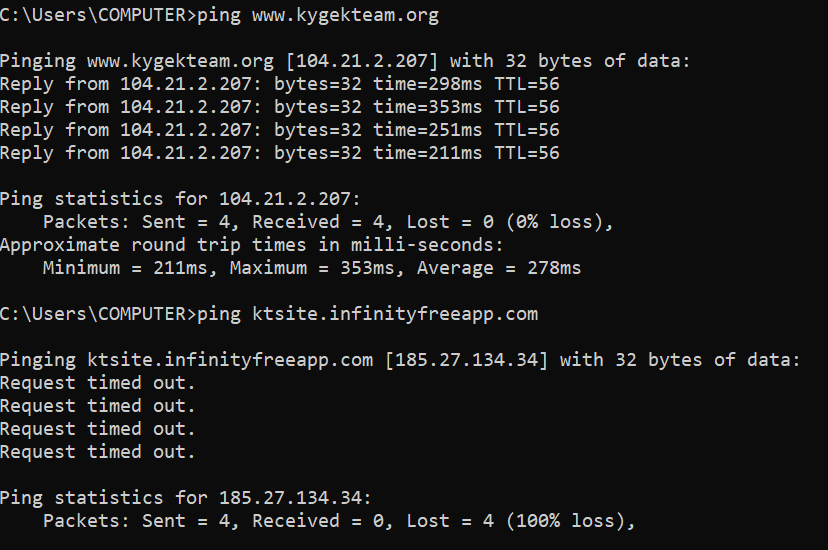

Now I am thinking that maybe root domain’s server ip’s have so many connections or loaded and cf getting slow result from origin server. To check if it’s true or not you can ping both of your domain and sub domain’s ip
I pinged both my custom domain and InfinityFree subdomain:
You can see “request timed out” for the InfinityFree subdomain because of these policy:
The ip 104.21.2.207 is from cf. it’s not your origin server ip.

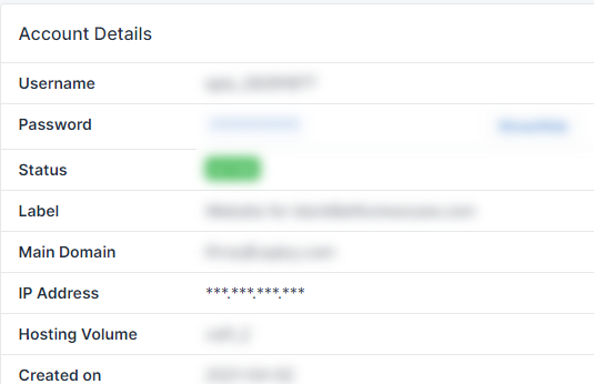

Go to your client area
You can see your origin server ip, now ping your server ip’s
You can see it showed “Request timed out” error because of this (I think):
Also if you visit http://185.27.134.34, you’ll see Error 403.
Oops! I forgot it. Yeah! you’re absolutely right
