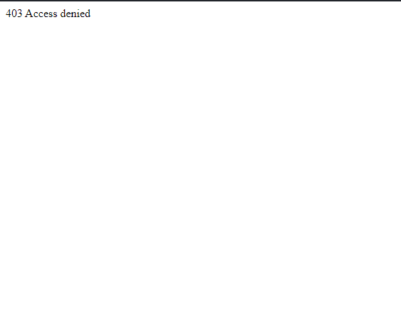

Website not work 403 Forbidden
dooo-admin.rf.gd
i cant enter the website how can i fix it?

now that appears
I had a look at your site and you appear to have done a lot more than install that .htaccess code I suggested. You also appear to have been modifying the Laravel directory structure, and have been mixing both Laravel’s rules, the rules I suggested, and some other rules entirely.
I think that this has resulted in an invalid .htaccess file, which is why you see that error.
