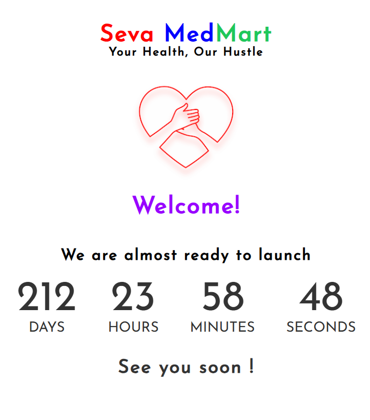

Works fine here

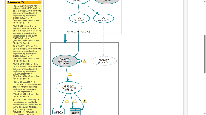

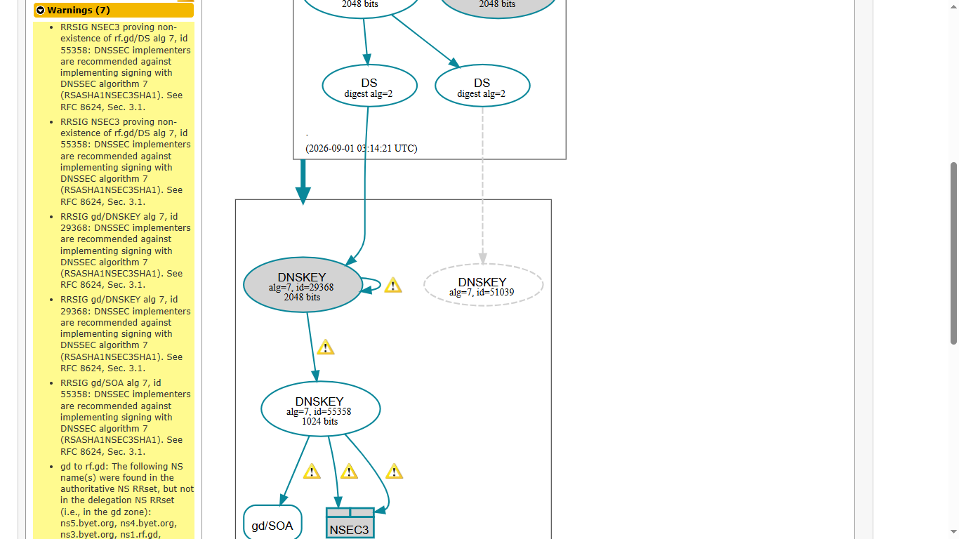

Thank you for the response. I have already performed extensive testing across multiple devices and networks, and the issue is specifically isolated to the Reliance Jio network in India (affecting both JioFiber broadband and Jio mobile data), which handles roughly half of the country’s internet traffic.
The site resolves perfectly on other networks (like Airtel and Vi) and via public resolvers like Google DNS (8.8.8.8). It also opens instantly when using a VPN.
However, running a deep DNS diagnostic via DNSViz reveals that this isn’t a random local firewall or antivirus block. It is a structural DNS configuration issue with the free subdomain infrastructure itself. The report shows a Lame Delegation / Nameserver mismatch between the parent registry zone and your authoritative cluster:
  1. The parent ‘.gd’ registry delegates ‘rf.gd’ to: ns1.infinityfree.com and ns2.infinityfree.com.
  2. However, those nameservers respond stating that the actual authoritative nameservers are ns1.byet.org, ns2.byet.org, etc.
Strict, RFC-compliant ISPs like Jio drop queries immediately and return a hard NXDOMAIN when they encounter a mismatched delegation chain like this, whereas more forgiving resolvers like Google DNS ignore the error.
