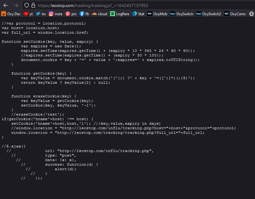

By this it turns out that your jquery is infected :slightly_smiling_face:
It is easily possible that someone pushed the obfuscated code inside or otherwise hid it

Or you use some demo or unpurchased software (pirated)
so the author checks if the host is valid (for which someone bought some software), and if not, then throw out the error and make a redirection.
And you should definitely do a jQuery script update if possible and if everything works

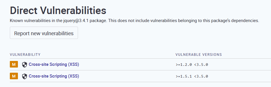

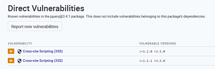

You are better off using up-to-date CDN hosted jQuery.
I use JsDelivr CDN. Here’s how to include their jQuery:
<script src="https://cdn.jsdelivr.net/npm/[email protected]/src/core.min.js" crossorigin="anonymous"></script>
It depends on how the malware came to be there in the first place. So no, we have no step by step way to fix this, because there are a lot of variables to account for.
For starters, you should take a good look at the software you’re using:
  • Is the software being actively developed and maintained, and are you running the latest, or at least supported, version?
  • Is the software being developed by a reliable party? A well known company is a safer source than some random person on a forum.
  • Did you get the software from a reliable source? So a distribution channel linked to by the software author, not some random file sharing sites you found through Google.
If the software is outdated, built by someone with either bad intentions or someone who just isn’t good at writing safe code, or retrieved from an unreliable third party source, your best bet is to wipe the entire site and start over. And go for software which is safe if you do.
Replacing the infected jQuery can help, but not if it’s just one symptom of unsafe, malware infected software.
