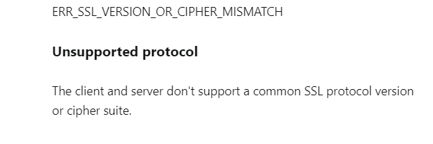

Hello I keep on receiving this error and I dont know what is wrong with my infinityfree ssl. How can this be solved? I can’t even get on my admin page.
Unsupported protocol
The client and server don’t support a common SSL protocol version or cipher suite.

That’s a bit of a weird error, can you share your URL?
sure.
https://greatlaptops.ga

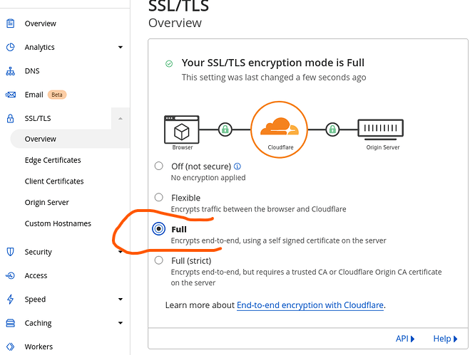

Or you can just set Cloudflare to “Flexable”, it should work fine then.
I did that too actually.
I see the same error code, but in my own browser. So seeing how your domain is using Cloudflare, it means Cloudflare does not have an SSL certificate for your domain name to use on the frontend.
Cloudflare should do this automatically. Please make sure you have the “Universal SSL” option enabled in Cloudflare.
It’s also recommended to setup a certificate on your hosting account to secure the connection between Cloudflare and our servers. But that won’t fix the issue, this is a problem on the Cloudflare side.
Yea the Universal SSL is enabled on cloudflare. I also tried getting the ssl on infityfree again but it just doesn’t install.
Ok I tried disabling and enabling the Universal SSL again and right now its showing a 502 error.
if you have a self-sig cert installed on our hosting, then switch it to full
if you don’t have it then switch to flex
