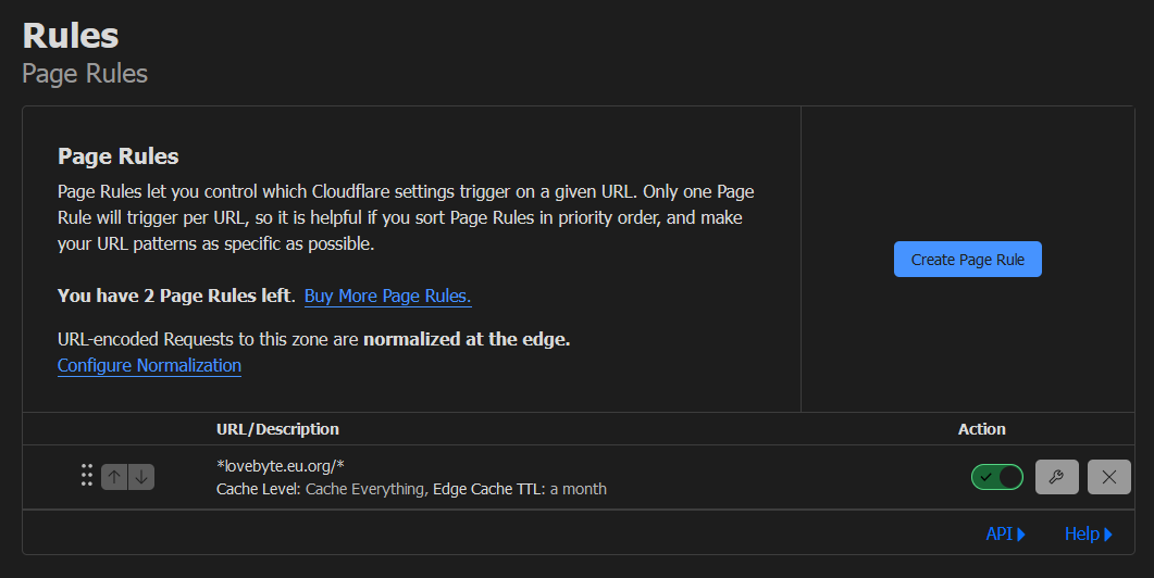

I have this
and this
should i change something?
I know that’s why I mentioned it above
I just never suggested you choose “ignore QS”
because I don’t know your site from the inside and what PHP code does
(you would then need to reorganize the entire menu)
if it doesn’t do anything special then I don’t know why to use PHP when you can simplify everything using html.
But like I said there isn’t any big difference because imgs and the rest is served through the cache just not the PAGE code itself (.html as cache)
