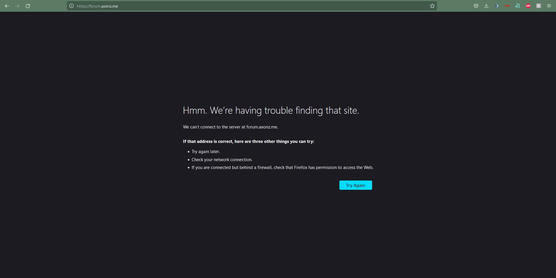

Subdomains dont work
i have made this again
tho still
they dont work

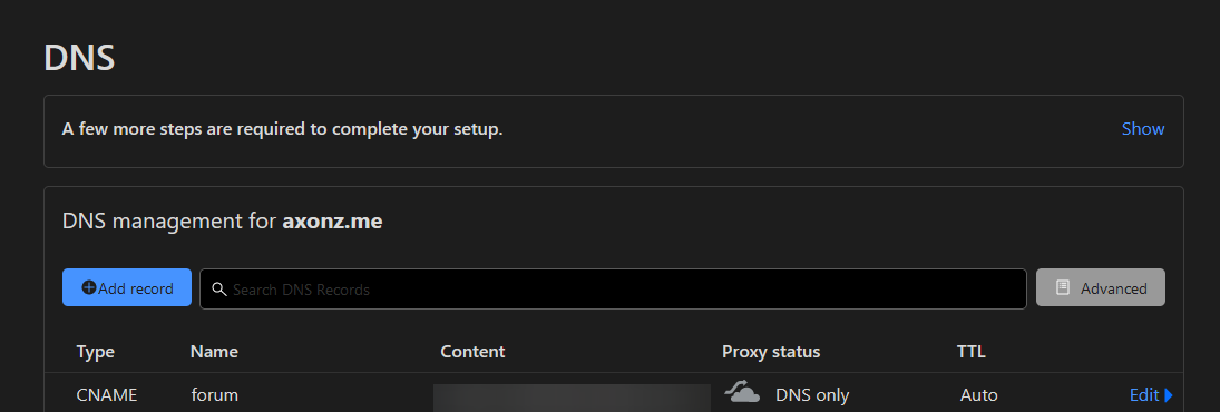

the url that i am trying to acsess is https://forum.axonz.me
and i have successfully added a SSL Certificate

https://forum.axonz.me/ isnt workin
it was working yesterday
help
You have mixed nameservers.
You created this mess yourself
If you are using CF, remove the epizy nameservers.
Make sure A or CNAME record is available for subdomain if using CF.
You may refer to this guide below

The DNS record you set for forum.axonz.me in Cloudflare is invalid, so half of the time and for half of your visitors your website will not work (depending on whether they connect to Cloudflare’s nameservers or ours). These inconsistencies are also the reason why you should not use multiple DNS providers.
