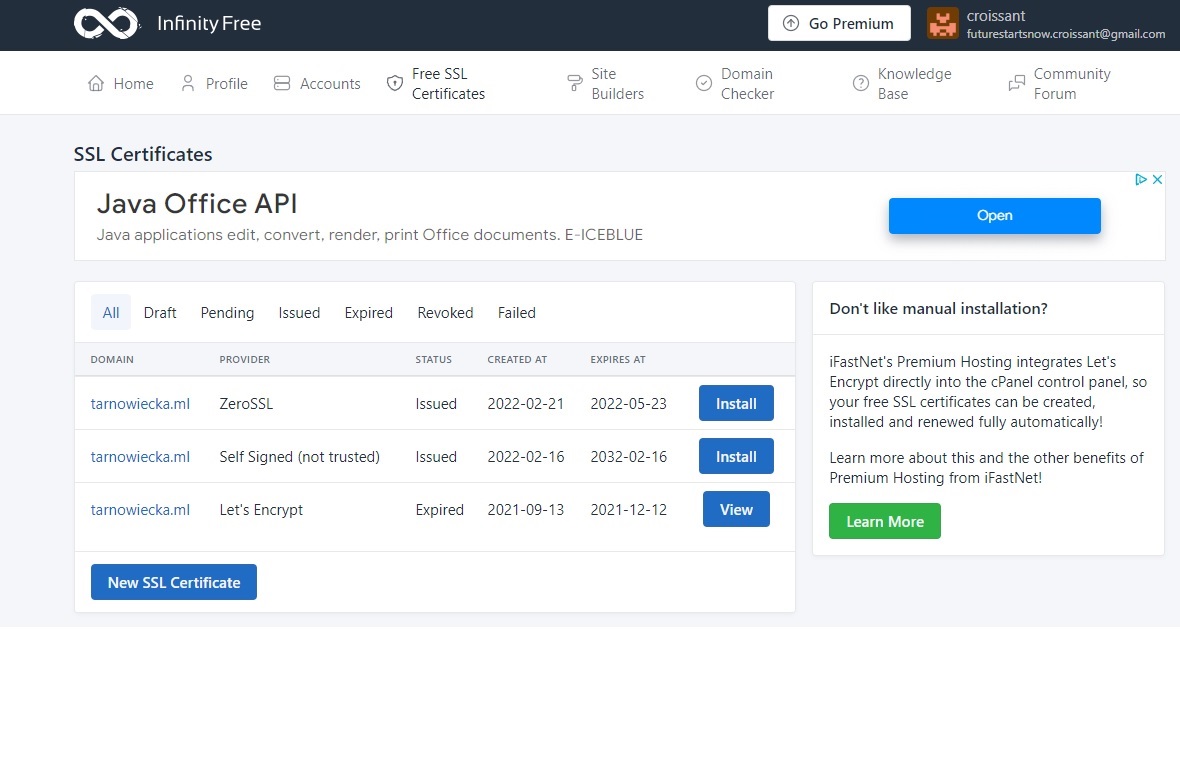

hey, i’ll create a new topic next time and i’m really sorry for my series of dumb questions but could you please check my certificate again? I installed a new one, but
i’m sending screens of my ssl certificate panel and as you can see the previous certificate and the new one have a status of an installed certificate - is this a problem? I have no idea how to remove a certificate.
I think the op from the previous topic i posted in made their website in a similar manner to me and they have a lock icon now so their certificate works, while mine still shows ‘unsafe’ while the certificate is valid.
Is there a way i could obtain the lock icon for free?
If yes, could you please be so kind and write the steps i need to take one by one? I really don’t have any experience with this and don’t really know what i’m doing yet.

I have no idea how, but the padlock has suddenly appeared so thank you all for your help.
This sounds like a case of SSL cache. Chrome and derivatives are known to remember old SSL data for a while, and clearing your browser cache does not clear SSL cache.
This is why I always recommend to test in Private Browsing mode, because it bypasses this cache.
