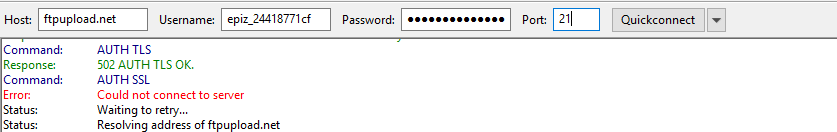

Screenshot:
why it is epiz_24418771cf? it should be epiz_24418771
I Did Do It Without CF In The Back Before And It Also Failed.
