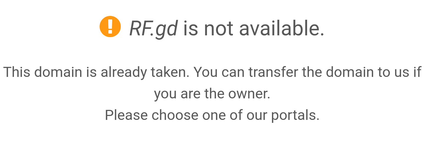

Since some time ago (presumably after) 17:00 UTC on August 10, the domain name rf.gd went down.
Subdomains of rf.gd are unreachable
With rf.gd itself being unreachable, all free subdomains of rf.gd are unreachable as well. There is sadly no workaround for this.

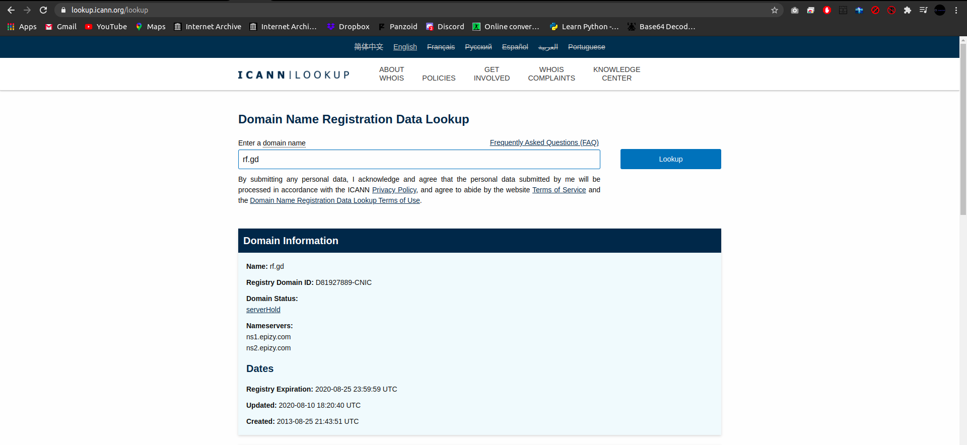

What caused this issue?
We suspect that the domain name was taken down by the .gd registry following an abuse complaint. However, we have not received any information from either our registrar or the .gd registry yet about this.
When will this issue be resolved?
We’re trying to get in touch with the registry and registrar to get more information about the current status of the domain, and if and when the domain can be restored.
UPDATE: As of August 12 16:00 UTC, the domain name rf.gd was restored by the registry! The domain name is active once again, and all sites should be coming back online soon.
