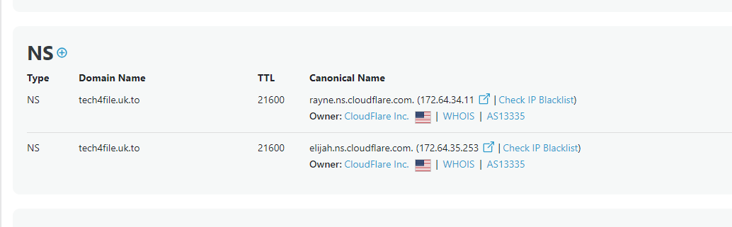

The DNS records in Cloudflare look fine. But when I do a DNS lookup for your domain, I see that Cloudflare responds with the IP address of your website with us, not the IP addresses of Cloudflare (which is what you want to see if you’re using Cloudflare’s proxy).
What’s interesting though is that in your screenshot, you have set “NS” records that contain both Cloudflare nameservers, but the actual DNS results only return one nameservers.
Could you please double check on the afraid.org side that the “NS Records” configuration is actually the nameserver configuration? Because changing the nameservers of your domain and changing the NS Records of your domain are not the same.

This is what I see
This will not work
Every domain name has certain nameservers associated with it, which control how the domain is linked to other services. Unless your domain name provider doesn’t allow it, you can change which nameservers your domain through your domain name provider.
Most domain name providers have their own nameservers which you can use, and you can configure the contents of those nameservers through the domain name provider as well. This is where you can set A, CNAME and NS records. The NS records are primarily used to delegate subdomains to other nameservers, but most people never need those settings.
So changing the nameservers of a domain name away from the nameservers of the domain provider is something completely different from setting NS records in the nameservers of the domain provider.

To use it with free hosting, yes. But that won’t work with Cloudflare, and it won’t remove the ?i either.
In short, domains from afraid.org cannot be added to CloudFlare.
