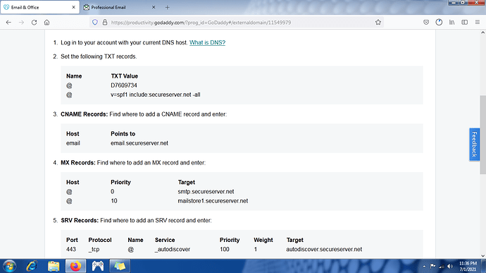

actually i am buy domain name from godaddy, and using webhosting from infinity free,so again i buy professional email from godaddy, i am not receiving email, when i talk with customer they told do this set up with your infinity free webhost, so i want to set up this thing
Set the following TXT records.
CNAME Records
MX Records
SRV Records
where can i set up this,
please help me
TXT records are not supported on free hosting. You can set up Cloudflare to manage TXT records.
You can create both TXT records through the “SPF Records” section. The CNAME Records and MX Records can be added through the sections with those exact names.
The only thing you can’t set is the SRV record. But that’s only a helper record to make configuring email apps easier. It isn’t technically required for your email to work.
