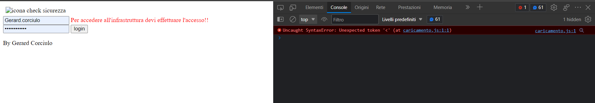

Uncaught SyntaxError: Unexpected token ‘<’

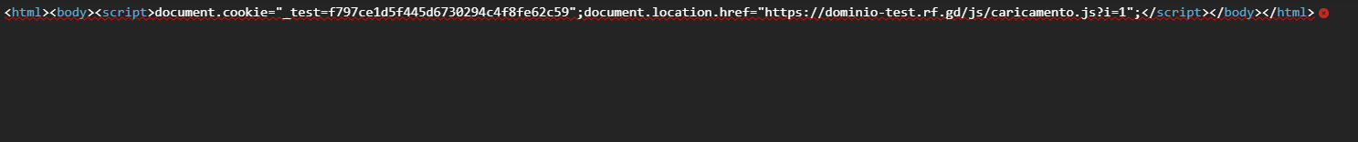

I have a problem with the GET method, the error I wrote previously occurs to me every time a new browser that has not previously downloaded the site files, uses a URL with the GET method, like: https://example.rf.gd/app/example.php?variable1=value1&variable2=value2 and the JS, CSS etc. files are not downloaded , and this error is shown on cookie files, EXAMPLE in image:
, help me please

https://dominio-test.rf.gd/app/autenticazione?id_infrastruttura="XdA-"&id_marker="Xg--"&i=1
this always happens with get method for the first print of site
[image]
the same as here and in several other cases.
It should have been fixed a few hours ago.
