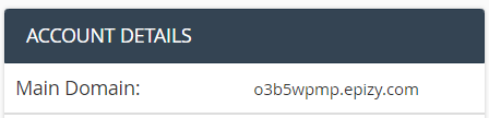

You instructed me to access the “client area,” which I couldn’t find, but I did locate the “ACCOUNT DETAILS” section where the “Main Domain” is listed as “xxxxxx.infinityfree com”. It also lists FTP username, hostname, MySQL username, hostname, and “Hosting Volume”.
I assume that “xxxxxx.infinityfree.com” is the connected apex domain (where the apex DNS record would point) if I were to use InfinityFree’s nameservers for my domain. If I am wrong, please correct me.

No you don’t, the main domain is for internal use only. You need the IP address if your account. It can be found on that page that shows the main domain. I would pull it for you, but I don’t know what the domain is.
Your main domain (which may be used as a CNAME record) can be found in the “Account Details” function where you shared it, indeed (for instance, here’s mine):

By the way, using the “Main Domain” as CNAME didnt work because it gave a error 500 but using the Website IP address as an A record worked.
So everything is working now.
Ah, thank you for sharing this. I was under the impression that using the main domain still worked; it’s probably no longer supported. Glad to hear the A record worked.
Well, it is still working for me
