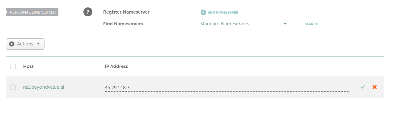

I tried to update the nameserver on namecheap, but they are asking for a IP address, not sthg like ns1.infinityfree.com. Copilot told me that the correct IP address is for ns1 : 45.79.148.3, so I used that.

I followed the link you sent, and tried to do what is needed. They use an example (spaceship) with a registar that accepts ns1infinityfreecom and ns2infinityfreecom as nameservers. Namecheap does NOT allow for these (or at least I couldn’t find where to add these in), and is asking for an IP address instead. That’s where i used the IP address given by copilot instead of ns1infinityfreecom and ns2infinityfreecom (dots omitted as I cannot post too many links as a newbie on this forum)

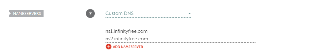

On your case you might have to follow these instructions, changing the nameservers from Namecheap BasicDNS to CustomDNS before putting our nameservers in:
That page you showed on your screenshot might be the one for glue records instead.
I was indeed in the advanced DNS section, not in the Domain DNS section, I think that’s the reason. I was then able to change the nameservers to ns1.infinityfree.com and ns2.infinityfree.com.
I’m just waiting for it to propagate as it’s still not reflected on infinityfree’s domain checker.
Thanks !
It works fine now, thanks so much !
