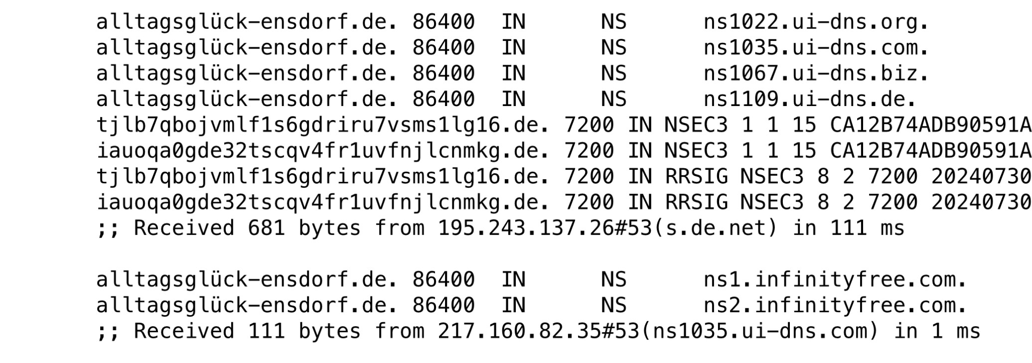

I am not sure what is going on, but there are multiple servers returning different namservers for your domain:
Try verifying with CNAME record instead, and using default namservers.
I know what’s going on.
The thing is that you didn’t set the nameservers of your domain, @PregLizZz. Instead, you created DNS records at your current DNS provider that refer to our nameservers. However, that’s not how setting nameservers work. Changing nameservers is always a separate setting from DNS records. If you’re not sure how to change the nameservers of your domain with your current domain name provider, please contact your domain name provider for assistance.
That said, with .de domains, you may find that you are unable to set the nameservers. That’s because .de domains have additional restrictions that prevent changing the nameservers ahead of time. The CNAME verification was developed as an alternative for this reason.
