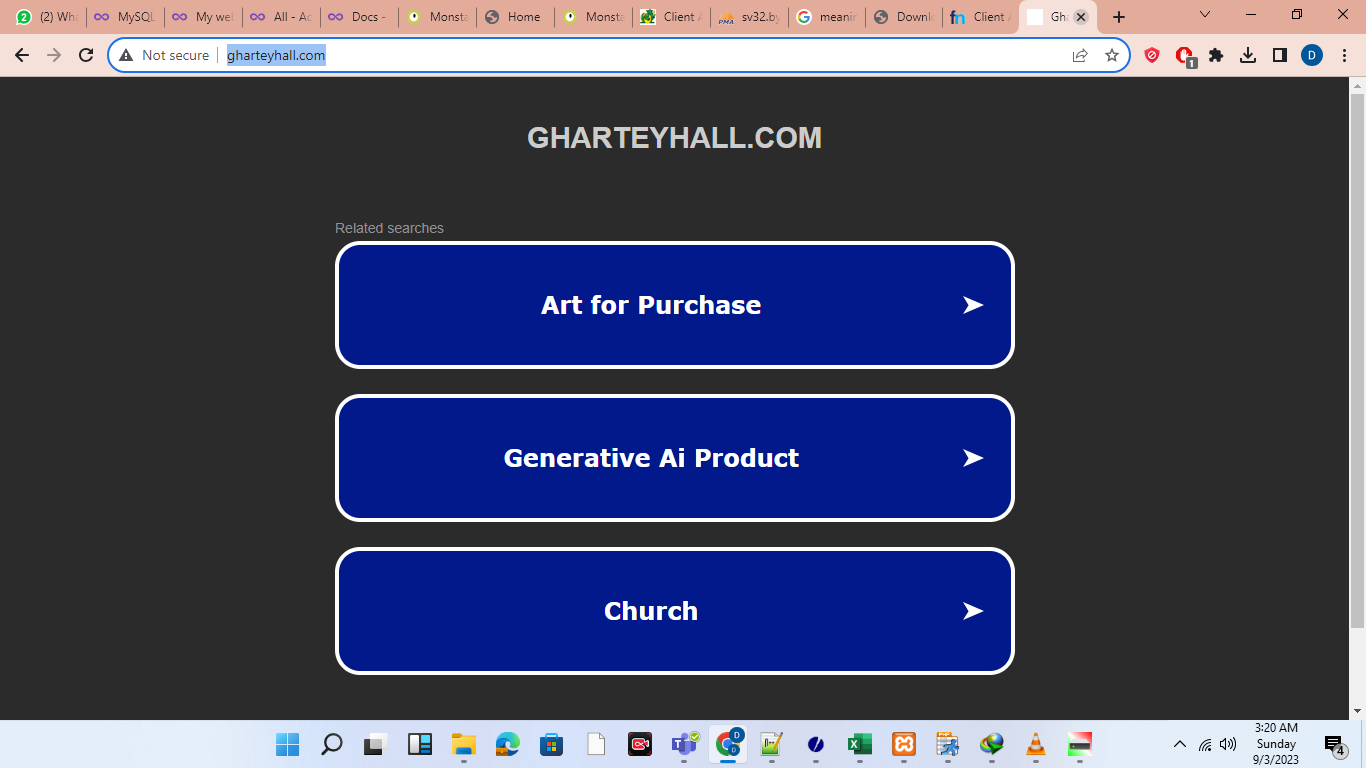

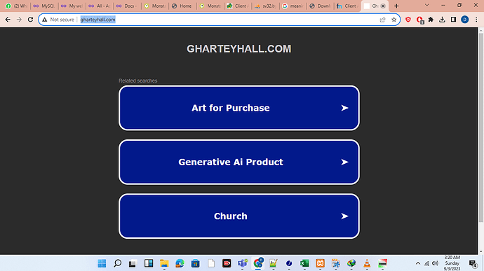

My website redirect me to a different place all together even though it has my domain name there
Website URL http://gharteyhall.com/
Error Message redirect to a different place all to even though the place has my domain name as heading that is not my website

it was not that at first when it didnt work that is why i changed the name servers to see if ti will at least point me to an error or a blank space but that thing was still showing so i was giving it time to propagate and see if it will point me somewhere else apart from that thing but yet it still show me that
why isnt it showing me something else??
i have changed it back to NS1.INFINITYFREE.COM, 2 and 3 but still showing me that thing
