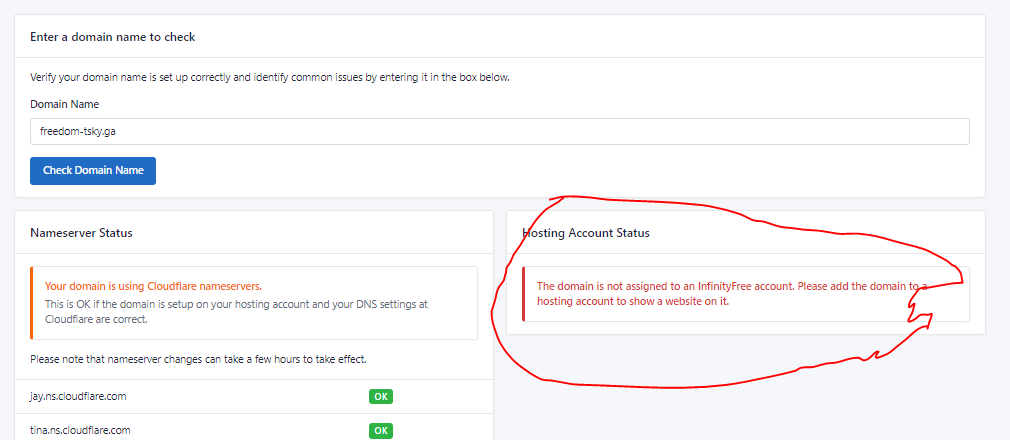

I’m having issues with Cloudflare CDN, I’m directed to iFastnet.com Special offer and Discount Coupon when I visit my site, here’s some info
###DNS Record:
Type:CNAME; Name:freedom-tsky.ga; Content: www.tsky.ga; Proxy Status: Proxied; TTL: Auto;
###Name Server:
freedom-tsky.ga is my newly registered domain name, I want to use it to speed up tsky.ga, tsky.ga can be accessed normally.
Hope you can give me some advice, thanks!

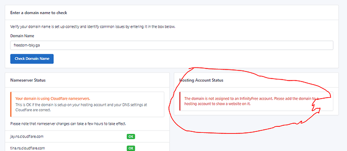

anon40084159:
freedom-tsky.ga
This is what I see
You need to add domain to hosting account first
Domain needs to be pointed to correct nameservers in order to be added as parked domain
Before adding your domain name to your hosting account, you need to point it to the InfinityFree nameservers. This guide will walk you through the necessary steps using Spaceship as an example. Keep in mind that different domain registrars have different interfaces, so the exact steps may vary.
Step 0: Find the correct nameservers
Before changing your nameservers, you need to determine which nameservers to use. The appropriate nameservers depend on your account type:
For new accounts or exist…
