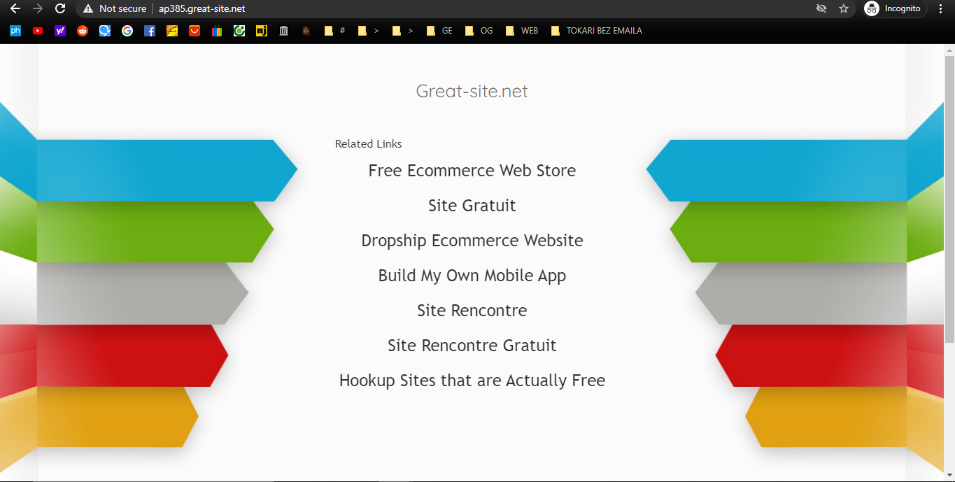

I’m a new user and i have a problem i see many here have with no hope for solution.
I uploaded my website to /htdocs removed the default index.html but still my page does not show up but Great-site.net dafault page. I read the knowledge base, i tried everything nothing changes. I don’t know if it takes like a day for site to activate or something, doesn’t make sense since i did not add a domain.
Does this work, i know for some people it does, but?
This is my url http://ap385.great-site.net/
My “main domain” is ptv0sdds.epizy.com
This one shows iFastnet.com Special offer and Discount Coupon
Hello there,
Have you already tried clearing your browser cache? You can also use Incognito mode to evade your normal browser cache.
That’s normal. You don’t need to worry about it.

I see the same thing @UnknownLolz posted, the site’s homepage and a large box, it has a continuous spinning icon like something will be loaded, but nothing appears.
For me your homepage seems to work fine, I checked the links under Services, they all come up with their pictures. No problems are seen, your site works.
Tnx for replies. I tried CTRL+F5 before and now also incognito, still same, must be the DNS catching up since i am from Europe, i’ll check tommorow.

You can also try flushing your DNS cache.
If you’re using Windows, execute this command in the Windows Terminal:
ipconfig /flushdns
I know the command, same. It should be ok by tommorow.
Works now, so it was DNS, but still no slider, i reuploaded it all, same.
