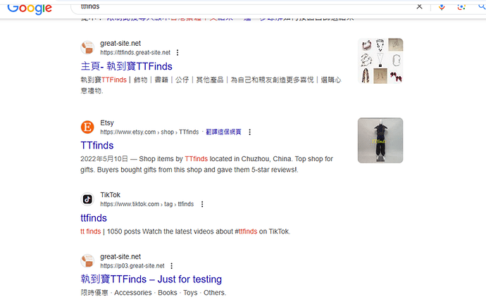

The other question is why the removed domain “p03.great-site.net” is still showing on Google. How can I remove it?
Thank you
You can if you have a custom domain
Search engine indexes take some time to update. The site will be removed eventually, but Google cannot wipe it from existence immediately the moment you click the delete button on our end.
I think Google has some kind of removal request form. But that’s mainly for cases like where confidential data was accidentally or maliciously published, not for websites that are no longer in use.
Better yet, you could restore the domain, and simply set it up so it redirects to your new domain. That way, any traffic coming from Google on your old domain will simply be directed to your new website, as opposed to being lost entirely.
