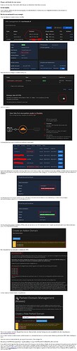

I shall try to be very clear…
I have tried to follow the post you referred me to but without no success.
Let me explain…
As I can’t add more than one picture and I obviously cant explain good without pictures I attach a png with the explanations… I hope it is ok..
I can’t read your pictures, they’re too small. Never mind, I can read them (magnifiers are a wonder).

Sorry for the picture… It is actually very big, 900kb, I could only upload 1 so… But if you click at the bottom of it, it open up in the middle of the screen rather than in the pinterest popup and then it get big when using the magnifier+ . Maybe that was what you did… I hope so, else it would have been very small lol.
