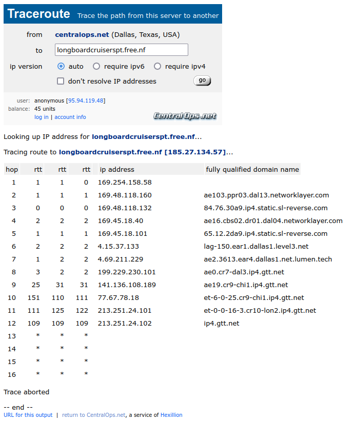

Here’s the traceroute output from https://centralops.net/co/Traceroute?addr=longboardcruiserspt.free.nf&ip-version=auto
Do you see anything wrong?
Unfortunately you can’t use traceroutes to test the connection to free hosting as the servers block those requests (As well as ping requests)
That doesn’t really help because that online tool does a traceroute from the server powering centralops.net, not your own network.

True, but it can still be helpful in this situation, as the connection being blocked at the network level or by the ISP would still terminate before even getting to the web server.

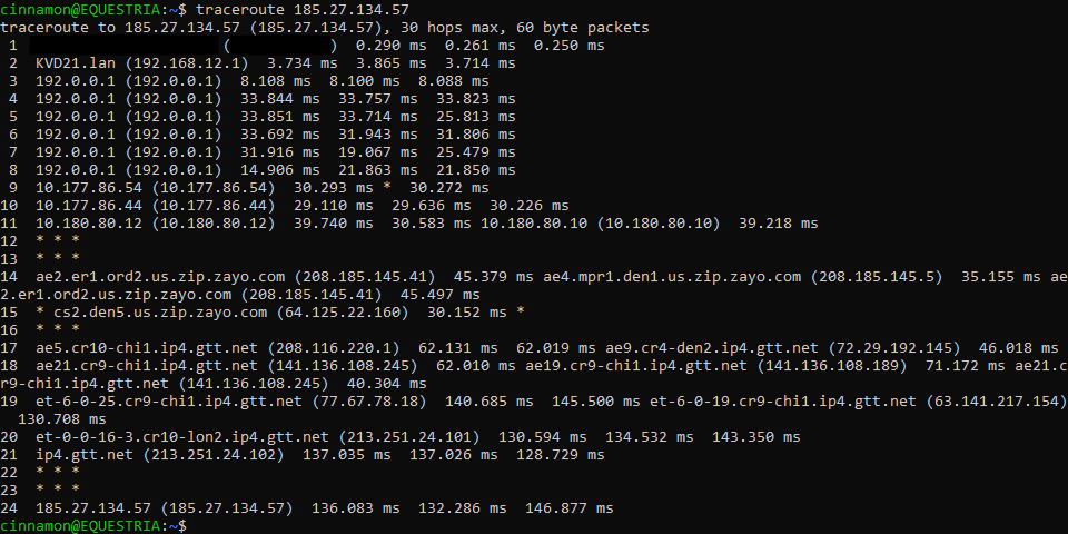

You can also try doing a traceroute on your site’s IP address directly (185.27.134.57) which should look something like this:
If it doesn’t, then your ISP is blocking the entire IP address, rather than just the domain.
