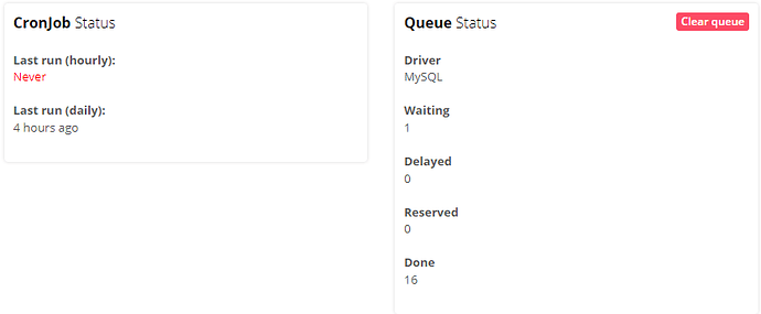

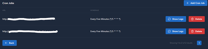

Cron Job setup (via infinityapp website):
(Both are returning status code 200 and message OK)
(Top is cron/run and bottom is queue/run)
HumHub cron info:

Honestly I’m not to sure this is all new to me… There are no errors.
According to HumHub there are item’s in the queue but it’s not running so I’m sorry I’m not sure
The infinity free web dashboard says that both of those jobs are Status “200” message “OK”

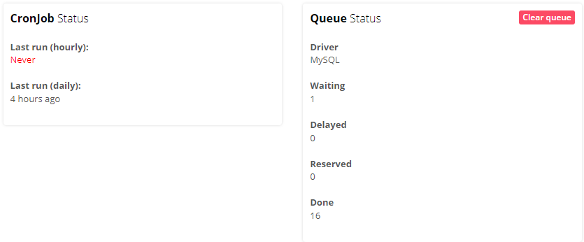

On the main page of HumHub it says
(Docs can be found above. | I set the cronjobs in infinityfree dashboard and now in cpanel.)
