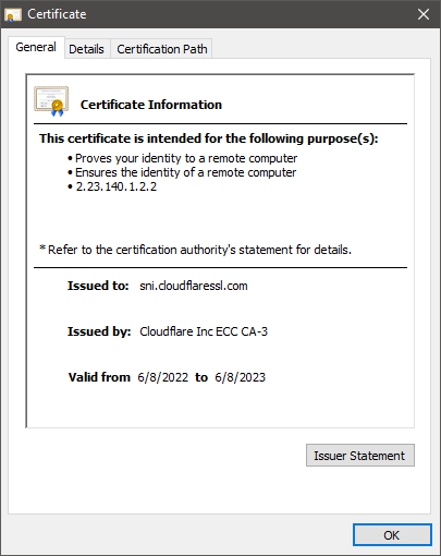

If clearing the cache does not work, select “Advanced” then “View Certificate”. Screenshot the pop-up window.

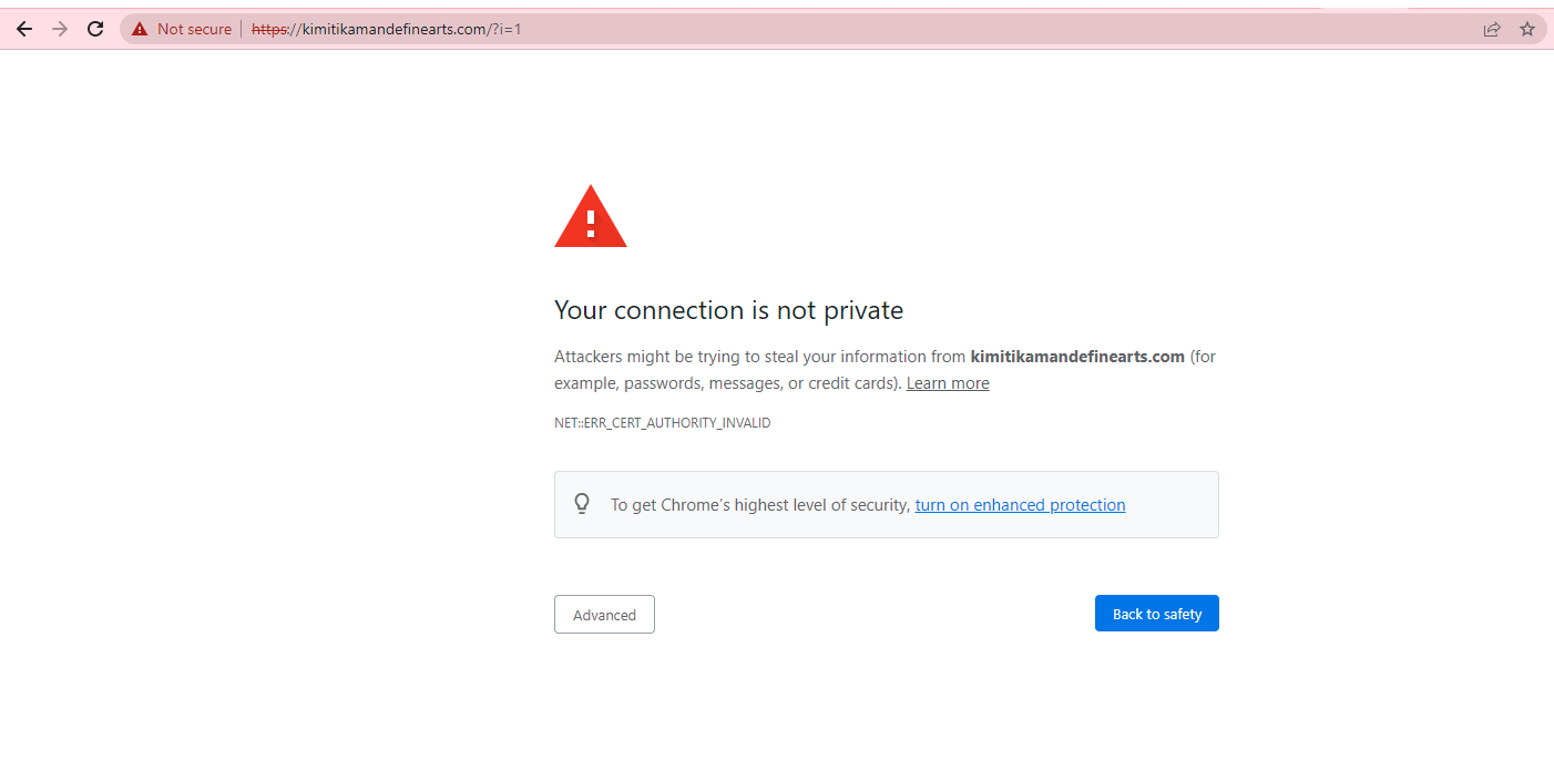

yes this is what i currently have, which Cloudflare asks me not to use.
Im told that even if Cloudflare configuration is secure now, my server is still not configured correctly, there’s a security error.

If you try to access the server directly, this is expected because it does not recognize the Self Signed SSL. If you are going to use Cloudflare, this shouldn’t be a problem.
This is wrong. In order to use Full Strict you must have a trusted SSL certificate. Cloudflare provides one that they trust, but it is not compatible with our servers. There is a workaround, however. You can use a provider such as Let’s Encrypt, ZeroSSL, or GoGetSSL here and use Full Strict.
