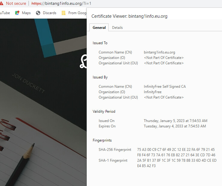

Question: how install cloundflare ssl i try the ssl not installed

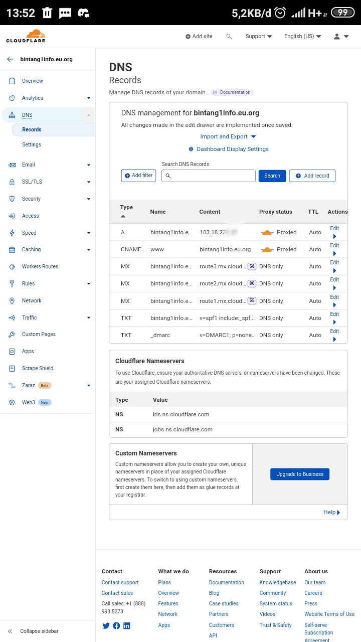

Also, please screenshot your Cloudflare DNS settings. Don’t blank out anything.

Good luck! I don’t think anyone will want to help you for blanking out the important info.

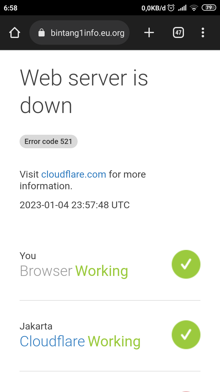

This is what I see now

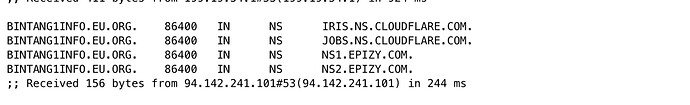

Your website seems to no longer point to Cloudflare.
Now I see that you are just using InfinityFree nameservers. In order for your site to work with SSL, you need to install a trusted certificate (From LetsEncrypt, GoGetSSL, or ZeroSSL).
If you want to use the self signed certificate, you need to use Cloudflare

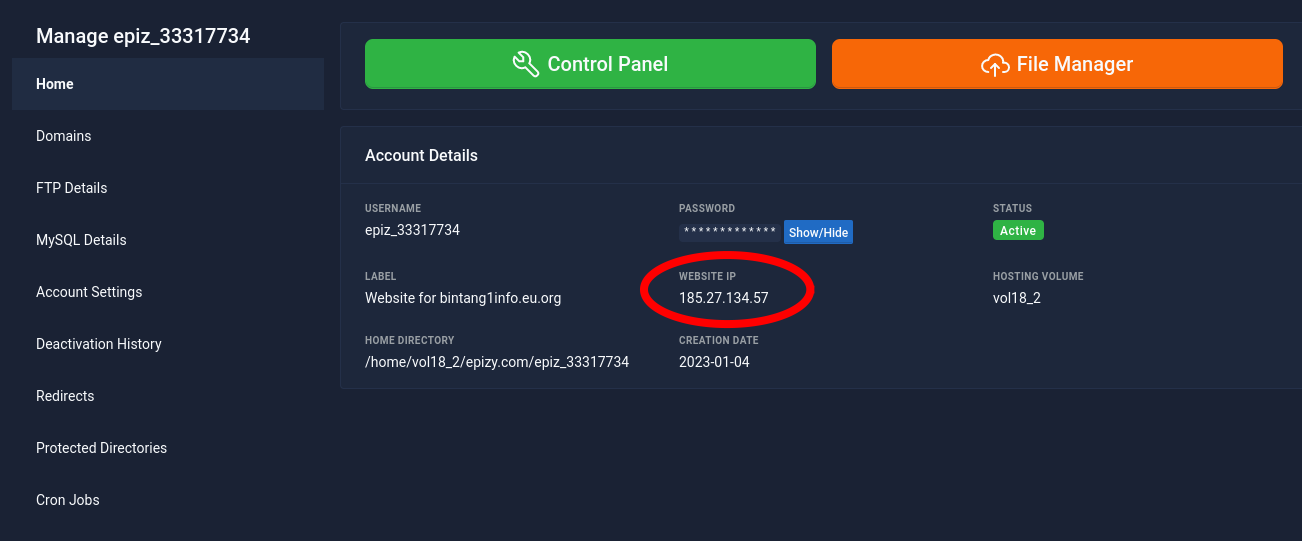

The IP address in for the first A record is not correct. Our website IPs currently all start with 185.27.134. So if you found any other IP, it’s not correct.
You can find the IP address of your website in the client area. Under Account Details is the value Website IP.

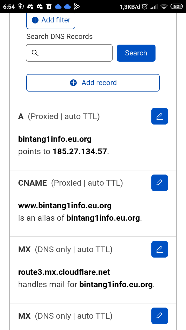

My A dns record is correct IP from client area

If you want us to help you, you need to stop changing stuff that was already correct. Now you have a new issue.
You can’t use nameservers from multiple different providers. Either use epizy nameservers, or use Cloudflare nameservers. Not both
Are you sure? Because the IP in the client area is “185.27.134.57”, and that does not match what you screenshoted in Cloudflare.
No. It isn’t.
This is the IP address you need to use.

Yes. NEVER mix different sets of nameservers, it will lead to a variety of very weird issues.
Please decide whether you want to use Cloudflare or not. If you do, please only use Cloudflare’s nameservers on your domain. And if you don’t, please only use our nameservers.
I’m pretty sure that your SSL issues will also be resolved if you don’t mix the nameservers.
