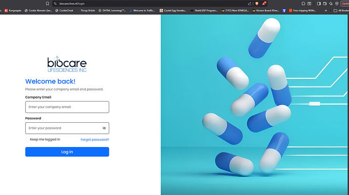

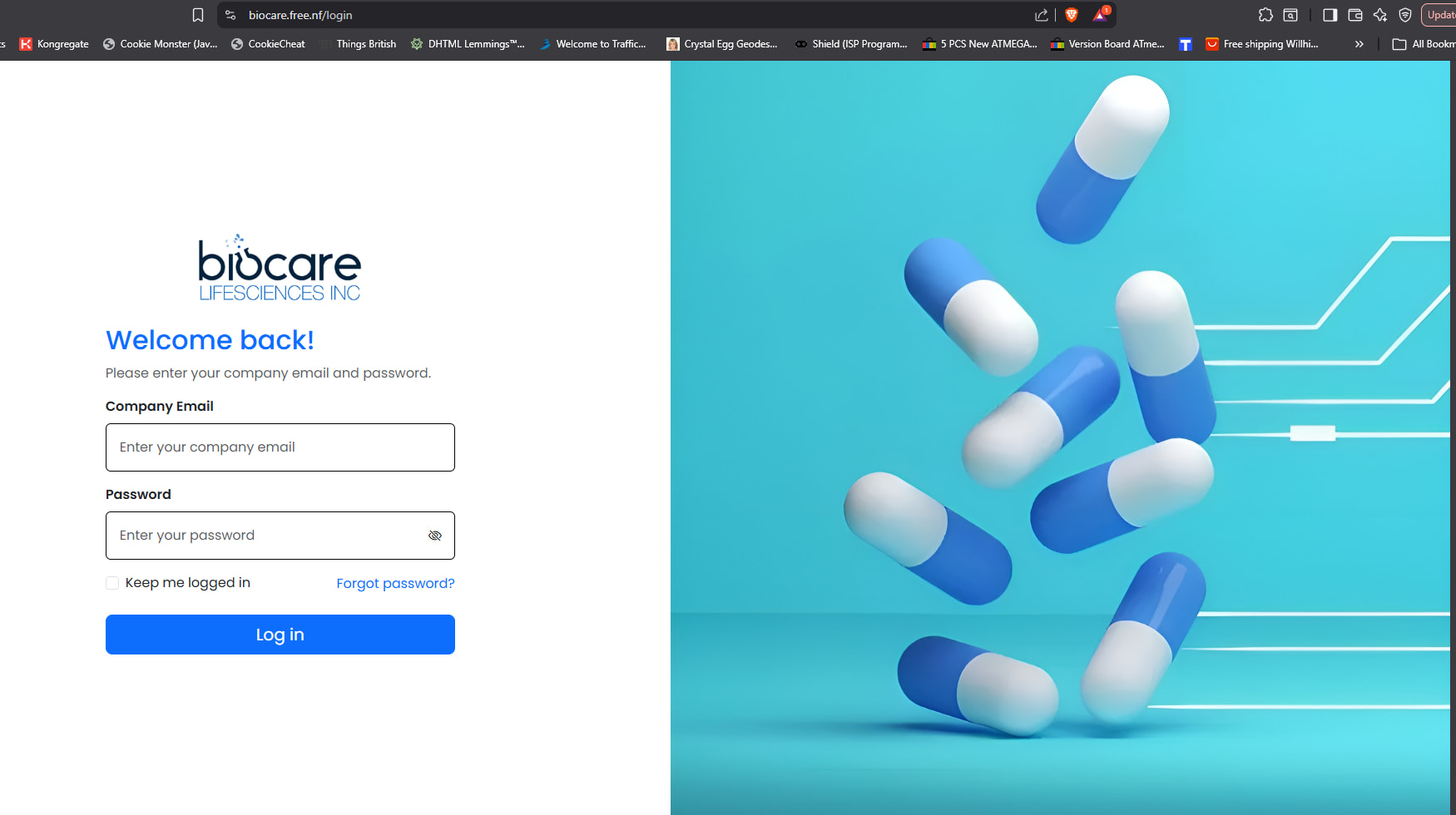

Your site seems to be working to me. But you did hyperlink to “my%20website” so clicking the link didnt work haha
