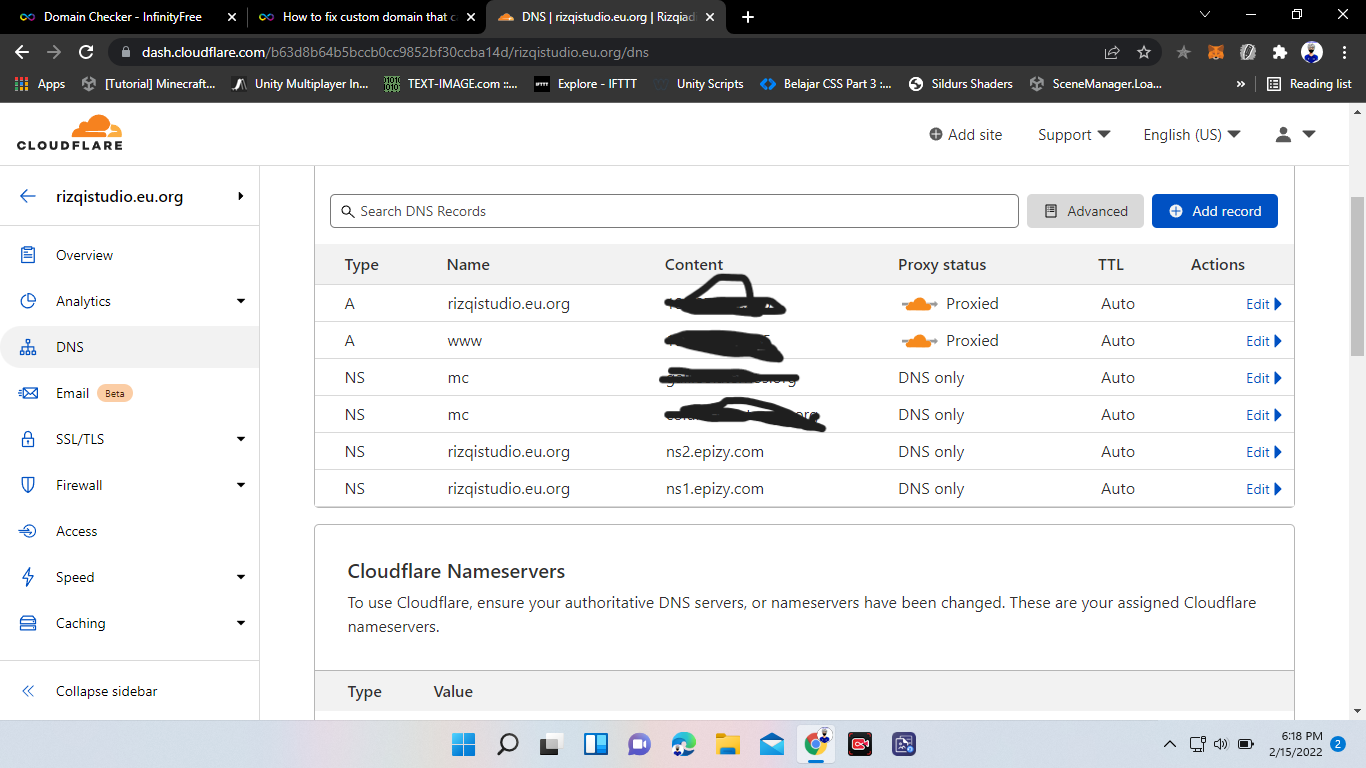

how to fix this error, how do I add ns to cloudflare, I’ve also been waiting 1 hour for this
You must change the nameservers at your domain registrar (nic.eu.org). Adding DNS nameservers does nothing, you must add authoritative ones instead.
I want to use cloudflare for ns on other hosting can here can’t
You must change the nameservers so you can add the domain to your account, then you can switch back to CloudFlare. Follow this:

This is what I see
If you do not follow @wackyblackie’s instruction, you can never use IF for hosting
rizqistudio.eu.org
What you have put in as ‘NS’ Records mean nothing to our system (as well as many others). Please follow my guidance below.
rizqistudio.eu.org and www A record. ip form app.infinityfree.net my website ip
Please write clearly. This is not helpful to me.
If you are trying to add your domain to a Hosting Account, please go to nic.eu.org and log in. Then, find your domain, click “Nameservers” and change them to ns1.epizy.com and ns2.epizy.com. Then, wait for propagation (which can take up to 72 hours) and then add the domain to the account. Once that is completed successfully, you may follow the process above, but replace the nameservers with the ones Cloudflare assigned you.
A record rizqistudio.eu.org and www A record that is my website ip I have seen the instructions but when I open rizqistudio.eu.org it redirects to iFastnet.com Special offer and Discount Coupon
what I boxed in blue was my website ip
Did you add the domain to a hosting account?
It looks like you have not.
how to add
Go to cpanel and click on addon domains.
Your domain has to be connected to an InfinityFree account before you can use A records.
