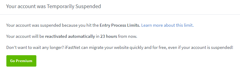

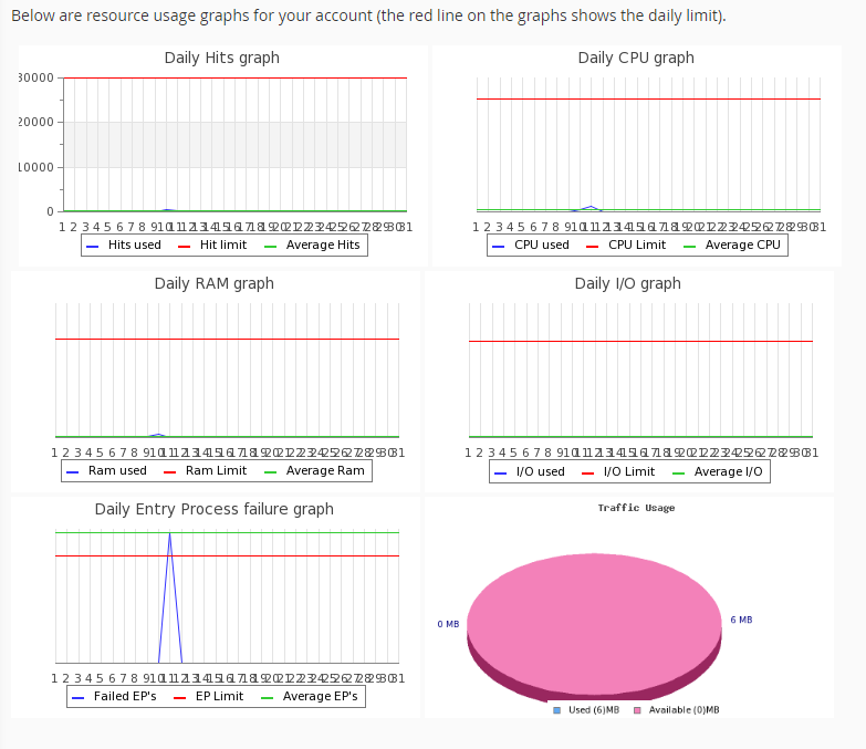

How to find what plugin causes EP limit error in WordPress
Please help me my account suspended
I know it will be reactivated after 24hours.
but i need to avoid this kind of error in future..!!!
EPLIMIT ERROR
MY SITE HAS NO VISIT TODAY..!!

Simple I’m asking without knowing the tracking history how I or we can solve the issue !
If someone can control the hits using limits then why its not possible someone can track what are the hits too?!
Anyways!
Finally I’m saying I’m not asking for the limits or blaming free plans!
I’m telling you atleast give option to track actually what eating ours limit!
