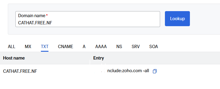

so you can import txt DNS for verify in zoho
i check my domain with zoho itself tools
that entry in photo is my SPF record
and its work as TXT
so you can import zoho verify TXT code as SPF in your panel
