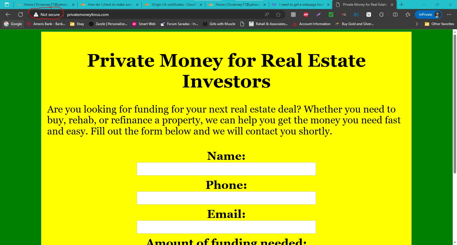

But I’m still having problems. My website is showing the “Not Secure” notice again. It could be that I did not configure the certificate. Can someone explain to me how that is done, please.
