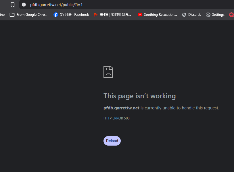

Sorry, I should have mentioned what it looked like. The HTTP response body was empty, so it was just the browser’s error message. And I noticed a header from “openresty” — no Apache, Nginx, or PHP.
The URL is http://pfdb.garrettw.net/

Thanks for your reply. After disabling the root .htaccess and accessing http://pfdb.garrettw.net/public/ I still get the same empty-body 500 error from openresty.

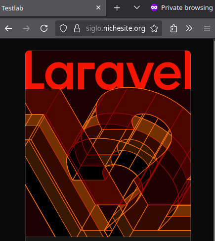

I see this
No openresty

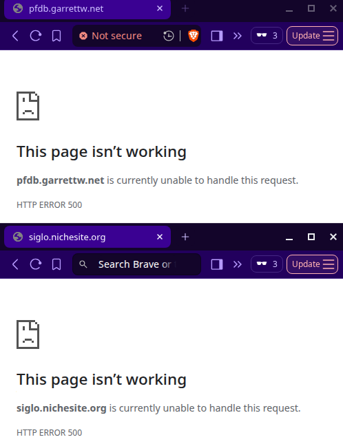

Thank you for confirming. I tried recreating this and it appears we have the same error now.
