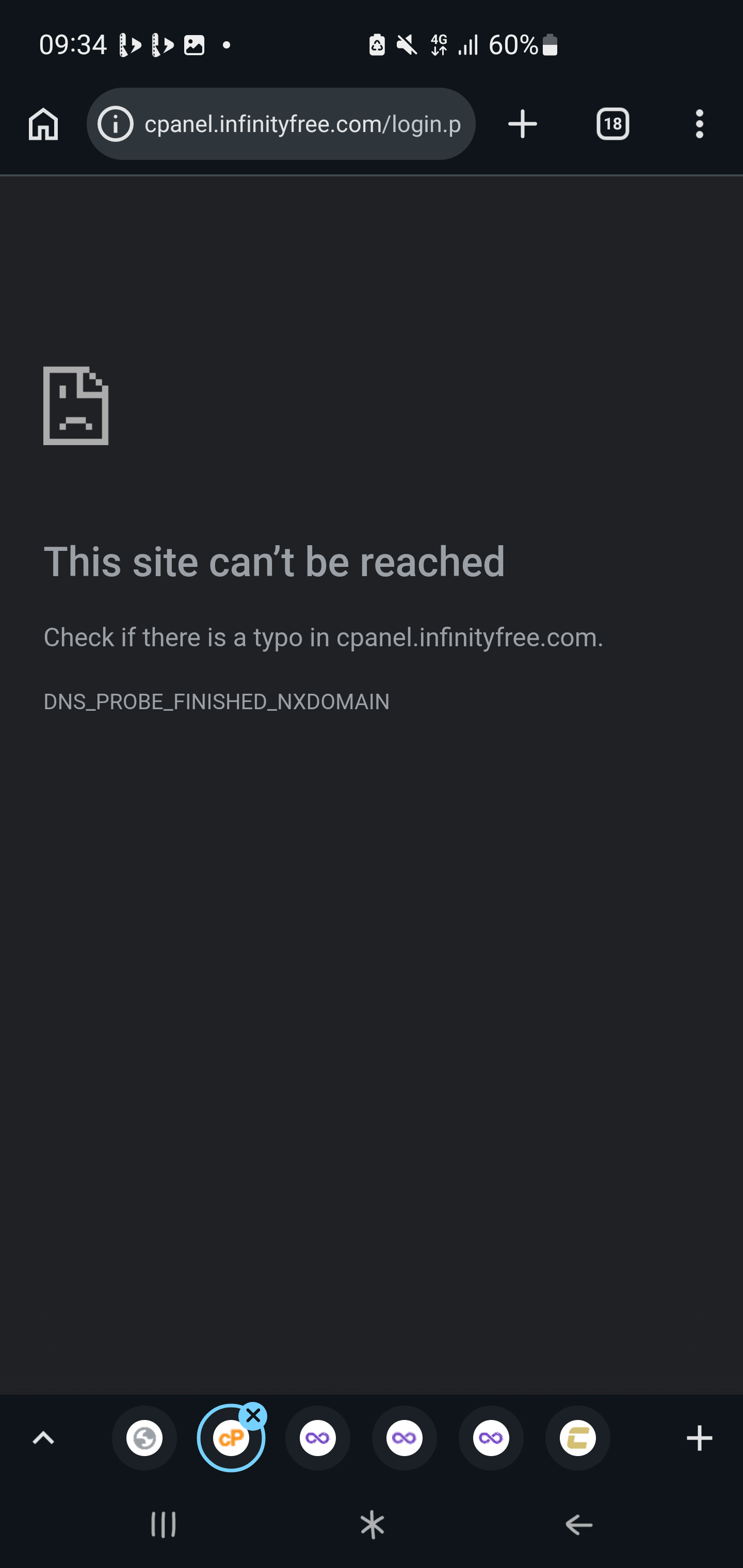

This site can’t be reachedCheck if there is a typo in aixerr.gt.tc.If spelling is correct, try running Windows Network Diagnostics.DNS_PROBE_FINISHED_NXDOMAIN
i hosted 3 websites on the .gt.tc extension and now all of them are returning an error that the domain name is not in existence

Yet it was all working perfectly before. Even until my last view this morning.
I can’t even open control panel try on your side too unless am on vpn which is bad

This sounds like your isp may have started blocking the domain
It’s worth reaching out to then to check this
I checked it, and both @john677998 and @12gemcares are connecting from Globacom in Nigera. Which is an ISP where more people have already reported issues accessing our hosting, like this topic:
So yes, this is very clearly an ISP level block. We cannot fix that from our end, please try contacting Globacom about this.
