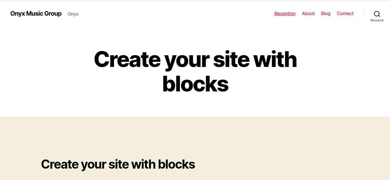

My website url is: https://onyxapp.cf
After the cloudflare “Under Attack” mode check, you site seams to work fine for me. Where are you experiencing this error message, and is something not working correctly?
