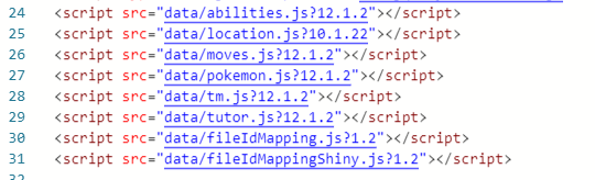

Furthermore, within the index.html file I’ve added versioning to the data files like so:
Is there anything that you recommend to include to lower the daily hit rate as much as possible?

In the screenshot, you load 8 different Javascript files. One way to reduce hits usage would be to combine all of these Javascript files into a single file, and only reference that single file. Doing so turns 8 (or more) hits into only a single one.
Thanks for the tip!
Is it right to assume that the number of requests displayed in the network logs is a way of tracking the number of hits the site will generate?
Generally, yes. However if you have PHP files that are calling other files behind the scenes, that can create additional hits as well.
