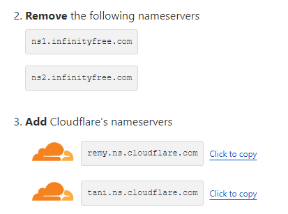

Hello, I want to add my site to cloudflare but its asking me to remove your nameservers and add theirs. I was wondering if this would mean my site would shutdown or something. Thanks.
It won’t shut down, don’t worry; you can still use Cloudflare with our hosting, just make sure it’s configured as per this guide to stay sure that it still works:
